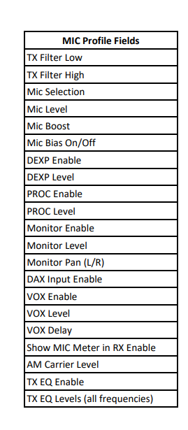

Mike-VA3MW Administrator, FlexRadio Employee, Community Manager, Super Elmer, Moderator adminOptionsThe VOX setting is stored in a the MIC Profile you are using and you see how they work in Section 18 of the SmartSDR manual.
Next time it happens, make sure you new MIC profile is loaded with VOX off. These settings are stored in the actual radio and then read by SmartSDR for iOS when it connects to the radio.
