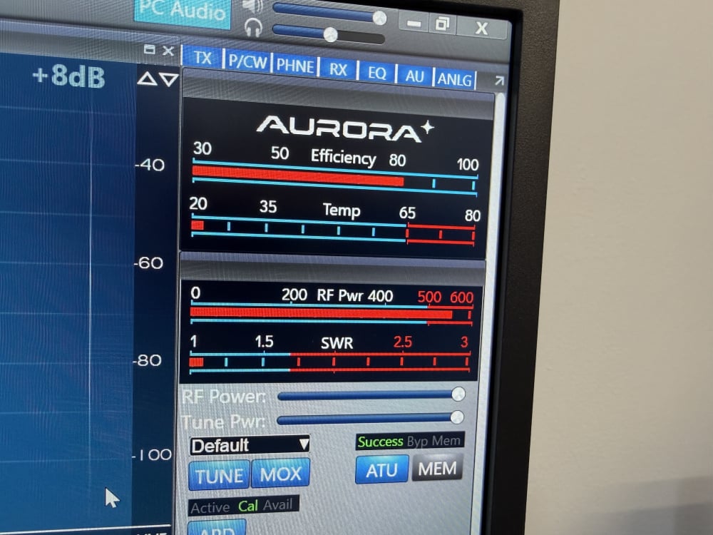

I've been using my Aurora for a couple days now on SSB, WSJT-X, FLDIGI, and CW (to key down for power test).
The power slider bar has never gone above 150 watts (RF is set to 100%). Most of the time it barely breaks 50 watts. I'm a new Flex user, so there's that....

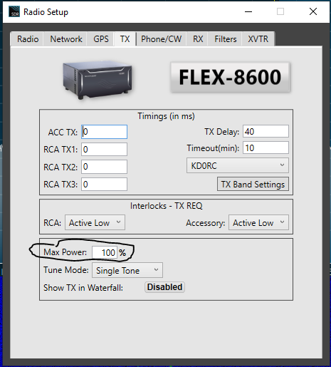

    Is Max power (screen shot above) and in TX band settings set to 100%.

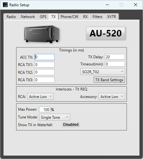

    You still have not confirmed you have max TX power set to 100% in the TX Band Settings (separate from the Radio Setup). You set it there for each band, and in the Radio Setup (TX tab) you set the it for the overall max TX power.

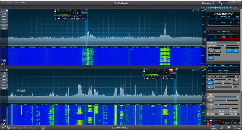

    I have posting privileges now! These screenshots show RF Power slider at 100%, radio setup Max power setup at 100%. The Tune button is clicked "on".
