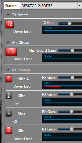

HI, after a reinstall of the v4.1.15 my SSDR gives driver error on the DAX part,
and there is no sign of all the flex drivers in the win11-audio menu.
Is it possible to restart just the DAX part or should I re-reinstall the whole v415 system?

HI All, almost solved the problem, I went back to v 4.1.3
Phil
I got the same DAX screen, shut everything down (radio) and rebooted computer and it was /is fine now.
@Phil_EBV Next time, simply open Task Manager, search for DAX, and terminate it. This is a faster solution than rebooting. I’ve encountered this issue multiple times before, but I haven’t been able to identify the conflicting component. It has occurred in versions 4.1.3, 4.15, and even previous versions that I’ve used.

I have the same problem. Cold restart doesn't fix the problem, SmartSDR neither v4.1.3 nor v4.1.5 create the required DAX channels. At first only DAX Audio RX 1 was missing. Now there are none.0
HI All and Flexed, yes I have also discovered that the Process_**** solves temporarly the problem.
