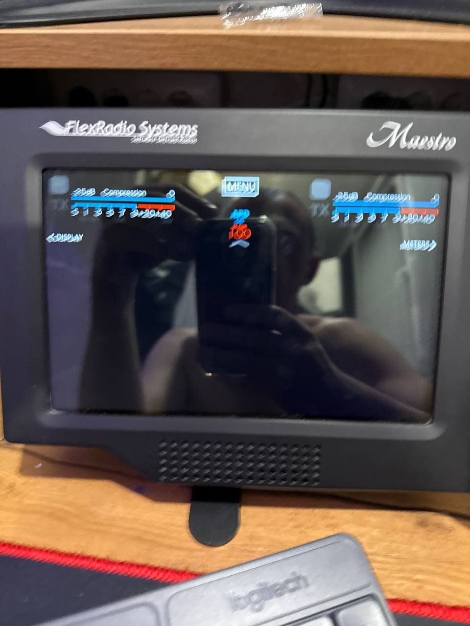

Maestro won't load
Hi Anton, export your profiles and do a factory reset. If that does not help, submit a help desk ticket.
My Maestro C does the exact same thing. It worked great after the update, but when I went to turn it on last night it stopped working. It actually reboots the 6400 completely when I try to connect. My Maestro B is working perfect so far with the new update.
Also when I connect using the Apple Smart SDR from Marcus on my iMac I can connect but if I try to change to 40m it reboots my 6400 just like the Maestro C does. Very strange things happening.
I had same issue on my Maestro A after updating to SmartSDR 4.0.1 on my Flex 6700. Windows and Mac versions of SmartSDR 4.0.1 worked fine, and it appeared that Maestro worked also until I tried to change bands and then the screen would lock up. After a few reboots the screen stalled at same point in loading as shown in original post, and when I touched the touch screen after the freeze Windows (version 8 as it turned out) presented an error dialog saying the Maestro is not responding. After more futile recovery attempts, I found this post and tried the full factory reset of my Flex 6700, and this worked! Maestro A is now functional again on SmartSDR 4.0.1 including changing bands and the other functions.0
I was thinking about a full reset, but I have not done that yet. My thinking was that if it is working on some devices, but not others, then maybe it was the devices that are not working.
So Mike, do you think that a reset could cure the issue?
Problems are all gone after factory reset! Thanks Mike!
I had the same issue, so I did a factory reset and all the problems were gone. Thank you.0
