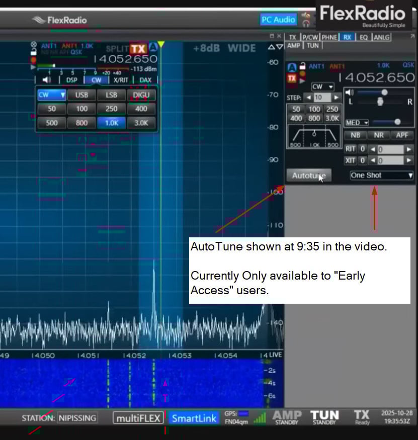

I do not see the AutoTune feature for CWI am looking at the CW drop down….
AutoTune Demo in the video here…at 9:35. Currently only available to "Early Access" users.
Al / NN4ZZ
