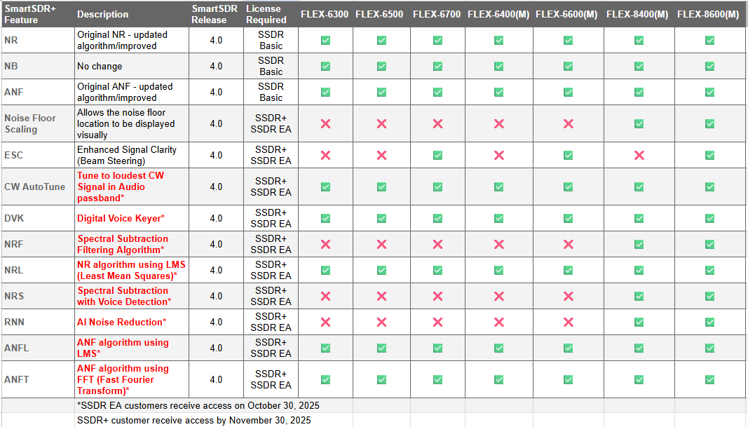

SmartSDR+ includes bug fixes and updates to new features for the next 365 days. However, new features that have not been released will be available after approximately 30 days from release date.
SmartSDR+ Early Access is similar to SmartSDR+, but you get the feature at least 30 days before SmartSDR+.

Hi Mark, Max Licensed Version is the license that you either paid for or that came with your radio when you bought it. If you purchase SmartSDR+, you will show a Max Licensed Version of 4.
So, 4.0.1 is free, but to get the new features, you would need to buy SmartSDR+.
