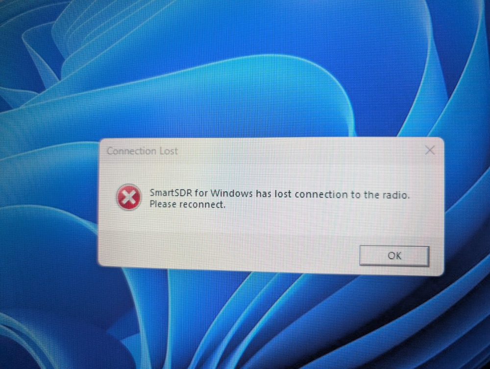

During WW RTTY on I think 4 or 5 occasions the radio disconnected and I got this message.
The scenario was I'd be transmitting and sometimes just on RX and then I'd start to see and hear jitter and delay on the audio tones, causing it to stutter and then 2-3 seconds after, the above message appeared, Smart SDR then closed.
I'd have to reboot the radio and just to be sure I'd reboot the PC and start everything again, once rebooted and connected, I could go back to doing the same as before without issue.

Mike-VA3MW Administrator, FlexRadio Employee, Community Manager, Super Elmer, Moderator adminOptionsHi Rich
Thanks for the detailed report and for sharing your setup — that’s very helpful. I’m sorry you’ve been running into this issue.
It’s also worth checking whether any RF might be getting into your network equipment, especially the power supply for the network switch or the LAN cables. We’ve occasionally seen intermittent disconnects caused by RF coupling into the network during transmit.
A link-local test will help isolate this: connect your PC directly to the radio with an Ethernet cable, bypassing the entire network (no switch, router, or powerline adapter), and see if the issue can be recreated. If it doesn’t happen in that configuration, it points to a network or RF coupling problem upstream.
I used power-line out to my tower for some time, but I found it was really bursty at times and then I would loose connections to the AG and a WebSwitch I had there. Is there anyway to test without the power-line adapters?
It still sounds RFI related. Was it specific to just one band/beam heading?
The way to narrow this down is to starting changing small parts of the topology and see if it goes away.
Let us know how you make out.
