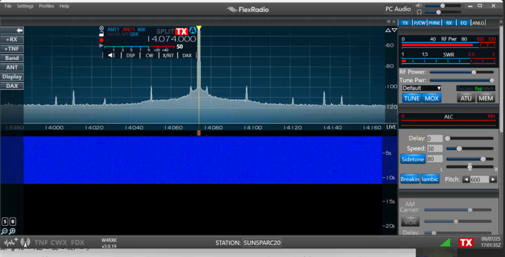

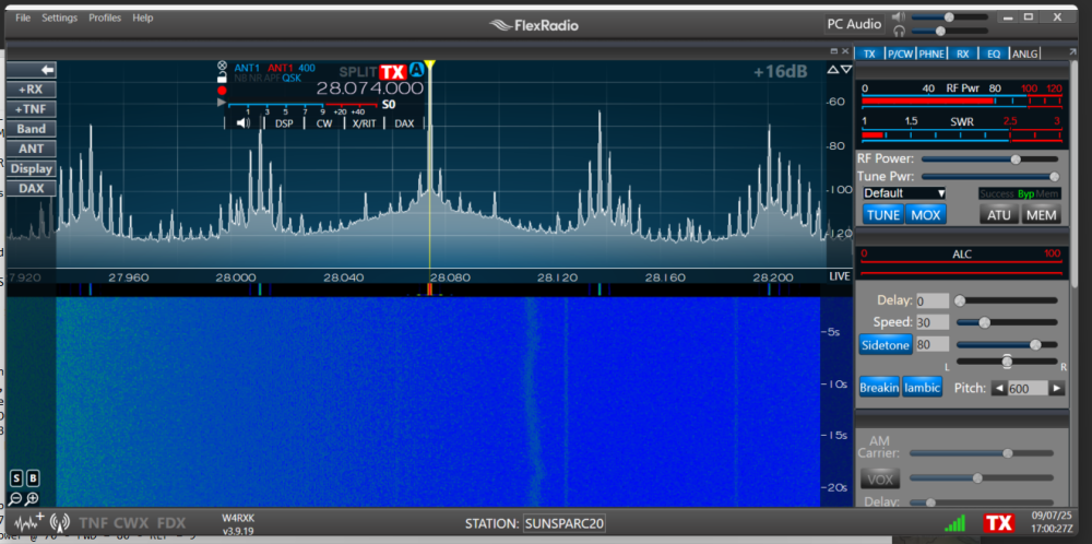

    I noticed on the band scope, 10m is very 'noisy' during TX as compared to all other bands. I can also hear the radio hum during transmit, louder on 10m than other bands. Just enough to be perceived as different.
    The same 'noise' appears with 5 watts tune power, only less pronounced (compared to 100w). The hum also dissipates as power is reduced on 10.
    After allowing the PA to cool down to 89, with tune enabled for 15 seconds, PA rose to 125 on 10m.
    After allowing the PA to cool down to 89, with tune enabled for 15 seconds, PA rose to 104 on 20m.
    On 10m, the PA temperature rises much quicker than all other bands. The same visual noise pattern on 10m with ANT 1 & ANT 2.

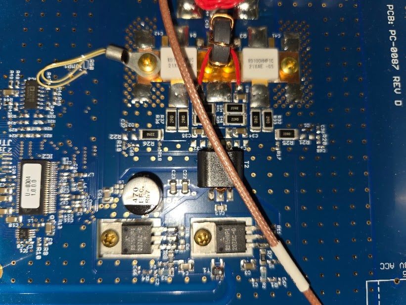

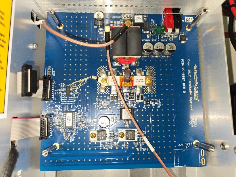

    I pulled the ATU and re-checked the fuse. It was in solid. When I pulled the middle board to get to the fuse, pulling RXA and LPF X2 connections to pull out the board, I noticed the LPF X2 cable was running right over the finals (?).
    There is no way to re-route this cable other than diagonal across the board to the LPF X2 connection on the right. So running over top of the finals like the photo below is the only routing option.
    As another troubleshooting step, I replaced the fuse with another 30A fuse. Put it back together, and the problem persists. Heavier amperage draw on 10m. No change.
    I see no visible damage to the boards ATU or middle board. Very clean.
    Would the routing of the PA cable radiate into the finals or other components if like the configuration below?
