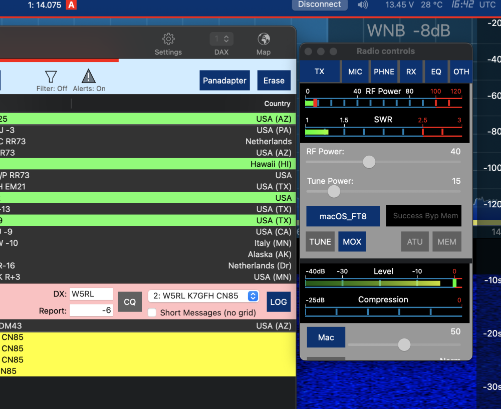

Posting this to the Mac forum as this is the flavor I run on my Flex 6400. I realize this may be a hardware issue. Per the attached screen shot, I am unable to see TX power on FT8 near my set power limit. In this case, 40 watts. I also have the same issue when tuning up. As the screen shot shows, my tune up power is set to 15 watts but I usually only see 1-3 watts per the meter. I am able to make contacts. Every now and then, the TX power will get close to the adjusted power level but not often. I have removed power from the 6400 multiple times, reboots etc., with no immediate change. Am I missing an ALC adjustment here, maybe this is normal? Appreciate any insight.
Jay (K7GFH)
Just curious, have you tried using WSJT-X versus the built-in FT-8 tool? In WSJT-X, you can adjust the output level. It would be interesting to see if you get any better results.
If you do, then I would suspect a software issue with MacSSDR, and reaching out to Marcus would be appropriate.0 -

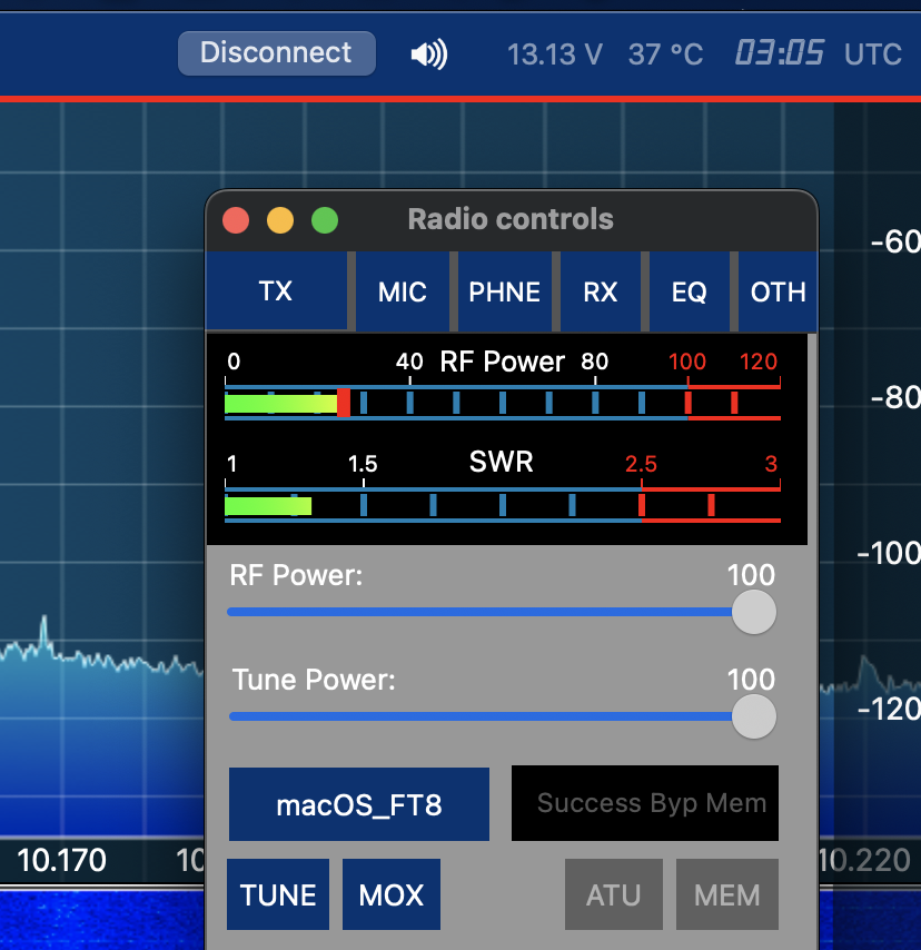

Thanks Bill. I have not tried WSJT-X outside of Mac SSDR. I was about too today then tried a few more ideas. The easiest to explain is in AM mode. When requesting 50W of power, the AM carrier is roughly 3 watts. Same with the tune function, requested 15 watts, actual is 3 watts as well. I figure if these simple settings are not functioning properly, digital will not as well. I believe I am leaning towards a hardware issue at this point. I do have an open ticket with Flex and fortunately, the 6400 was a recent purchase from Flex so hoping for warranty support if a problem is found.0 -

Thanks Mike. I am at roughly 13.14 volts when tuning at 100W. Requesting 100 watts yields roughly 20 watts. Requesting 15 watts yields roughly 3 watts. See attached screen shots showing both.
Jay0 -
