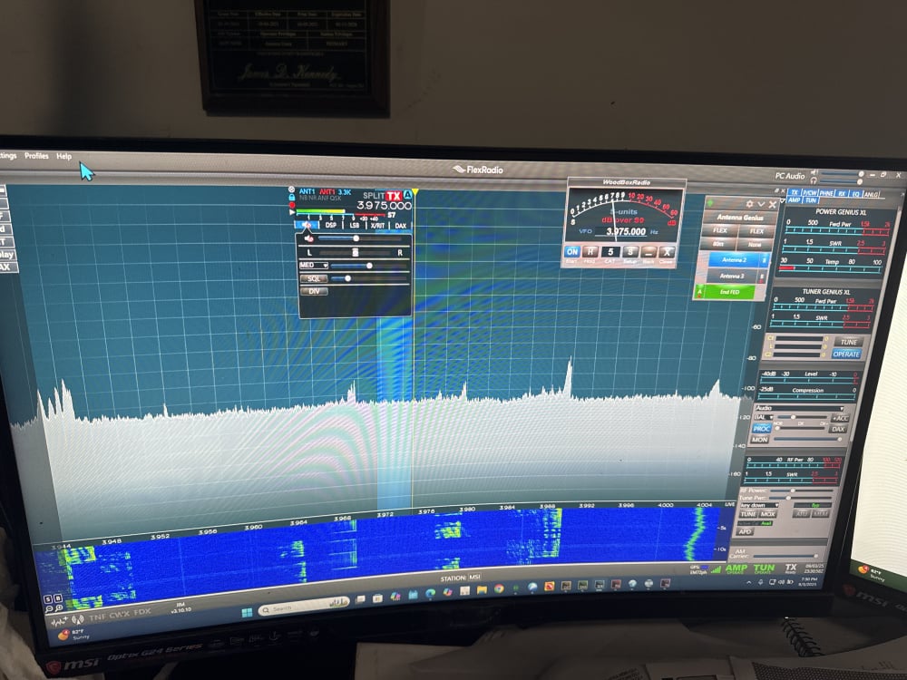

I notice this on two different bands, with TUN integration active. My 80m needs tuning about 3.800 so I dial over too 3.975 GA SSB net hit the Tune button nothing happened. I restarted SmartSDR no change. I only tune my antenna with Tuner App

At what Frequency does it start to work? It could be (and I am guessing) that a TUNE defaults to USB internally and your LPF for SSB is a very large number that takes you out of band. Without a screen shot I am sort of guessing the issue.
i MUST have explained it wrong, normally I don't use a tuner below 3.800 above that I need to use a tuner. so on GA SSB Net I dialed up 3.975 and hit the tune button TUN Operate is GREEN and nothing happened. I started the Tuner Genius XL app select band A and hit TUNE and it tuned the freq.

I have attached a screenshot
I rebooted the radio for third time and now the tuner on SMARTSDR works
