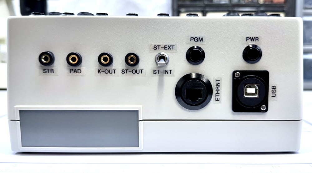

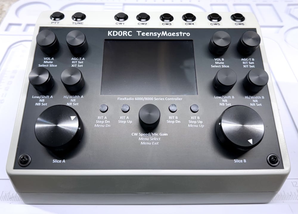

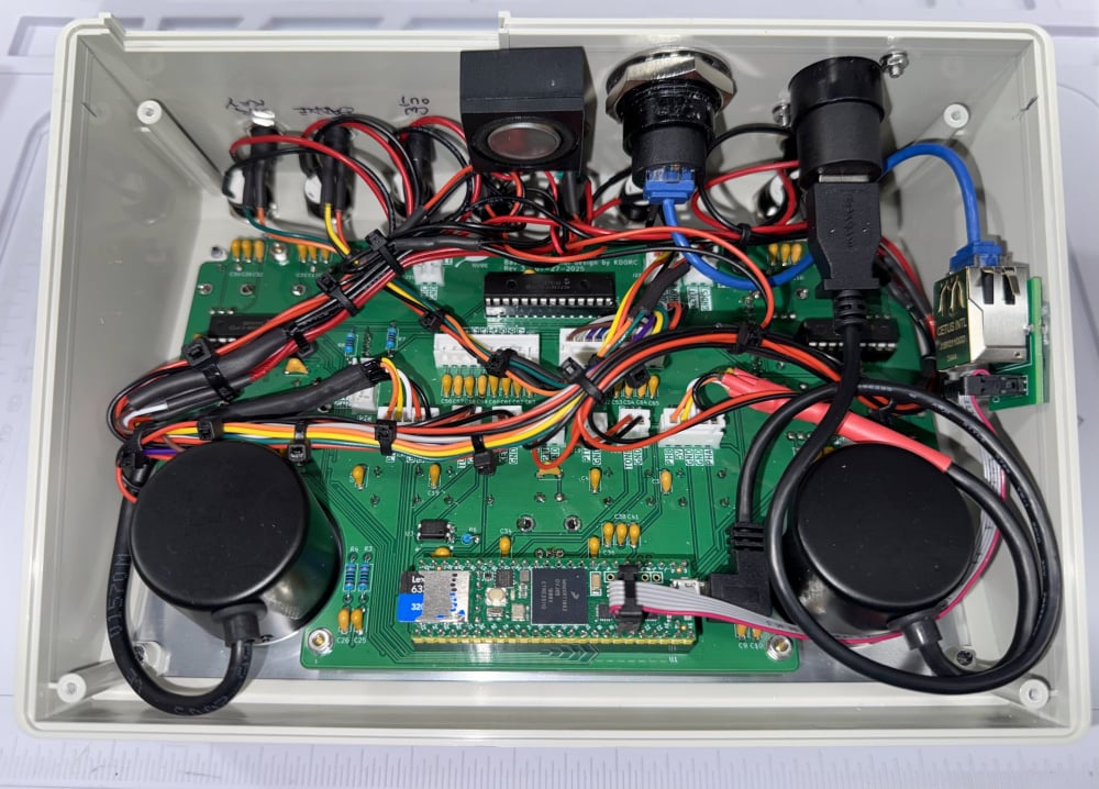

    I just finished building my new TeensyMaestro and it is working beautifully. Many thank to Len (KD0RC) and Simon (NV0E) for their excellent software and hardware design. Frankly the toughest part was accurate hole drilling for the buttons (I think I need a new set of drill bits).
    I added a switch to route the CW sidetone to either the internal speaker or rear jack. The intent is to use the TeensyMaestro's low latency sidetone as an input to my desktop mixer so I can improve over my MacSmartSDR's somewhat greater latency. Right now the external audio out is way too hot, so I'm anxiously awaiting Len's addition of a controllable audio amplifier to his design.
    For enclosure labels, I used a Brother P-Touch labeler with black-on-clear .23" tape, and I think it came out pretty well.
    This was VERY fun. 😁
    Wow, nicely done Bill! It looks great inside and out!
  • NV0E
    NV0E Member ✭✭
    That looks really good, Bill! The low profile look of your CW Message, PTT and Tune buttons is excellent.
