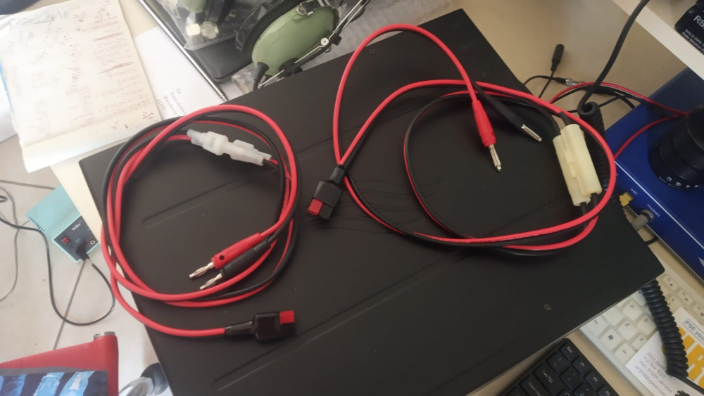

Cables made. 3.9 feet long. 10 gauge copper.
2 cables 7 buks0
