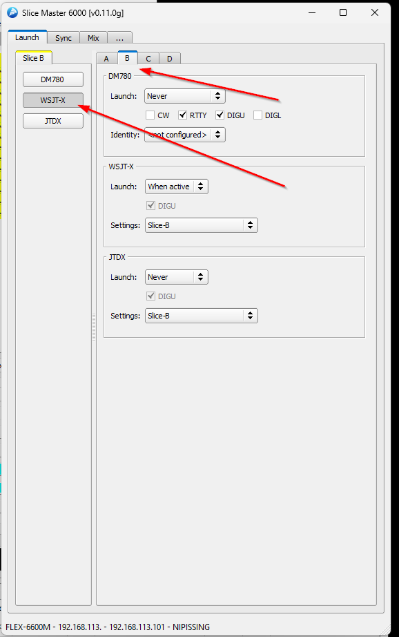

Something else, on SliceMaster I suppose to create a Launch setting with name DAX1 and DAX2 but it always change it to Slice-A and Omnirig...... I do not understand that0

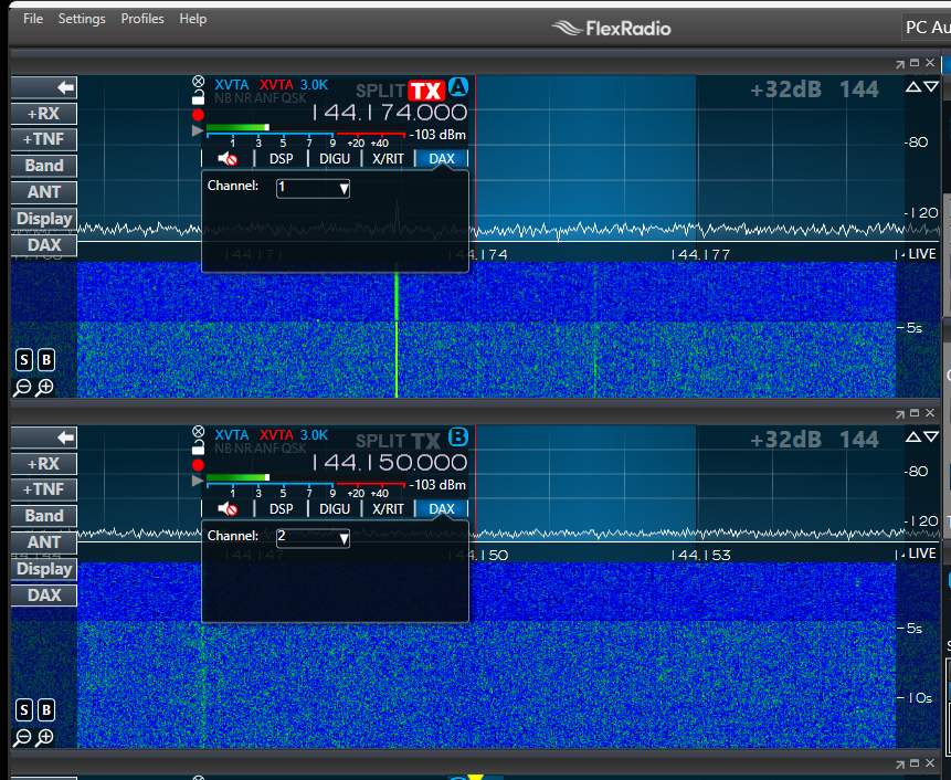

One the 2nd slice:
- Make sure you have a DAX RX channel assigned to the slice (DAX 2 is a good one assuming you are using DAX 1 for Slice A)
- Make sure you have the DAX Slice active

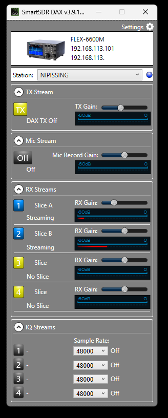

Here are some images in no particular order, but they should help. This is my 2M setup for today (one FT8 and the other MSK144).

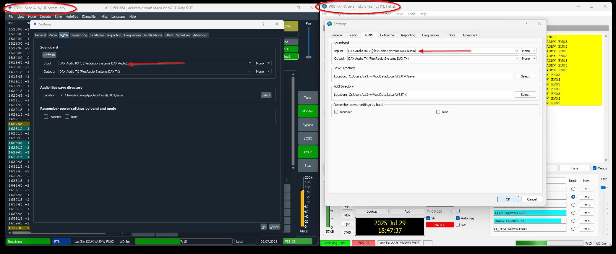

This is for JTDX and WSJT but the setup is the same. You want to check this after the 2nd decoder opens.
Thank you Mike for the comments, I saw your video for these settings and followed it, the only thing that didn't work is that Slicemaster keeps changing the launch name from DAX1 to Slice-A and from DAX2 to Omnirig......it shouldn't be and perhaps it is the problem. Do I need to make any changes on JTDX? do I have to duplicate the files, or something else.0
