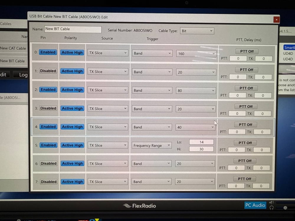

Good afternoon! I use a USb relay to control the antenna switch. Please tell me how to write the frequency boundaries correctly so that everything works? I tried different formats, but it doesn't work. The relay does not turn on when the frequency changes. I want to make sub-ranges for CW and SSB. I may not be writing the frequency format correctly in the graphs in the screenshot.

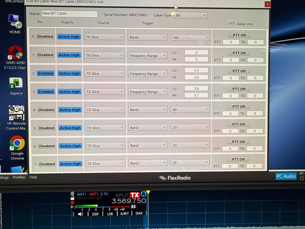

Doesn't want to work with such settings. Checked 2 different relay boards. The board itself is connected to Flex. Here is a screenshot. I need 6 relays to be additionally connected at a frequency of 3.5 to 3.6 MHz.
you have band and frequency range both being used. Try changing everything to frequency range instead of band. Example - 20 meters 14.0 - 14.350

Certainly. After all, when I display only the ranges, everything switches and works. but does not work only when specifying frequency boundaries. there is no reaction when I set the settings as shown in the screenshot

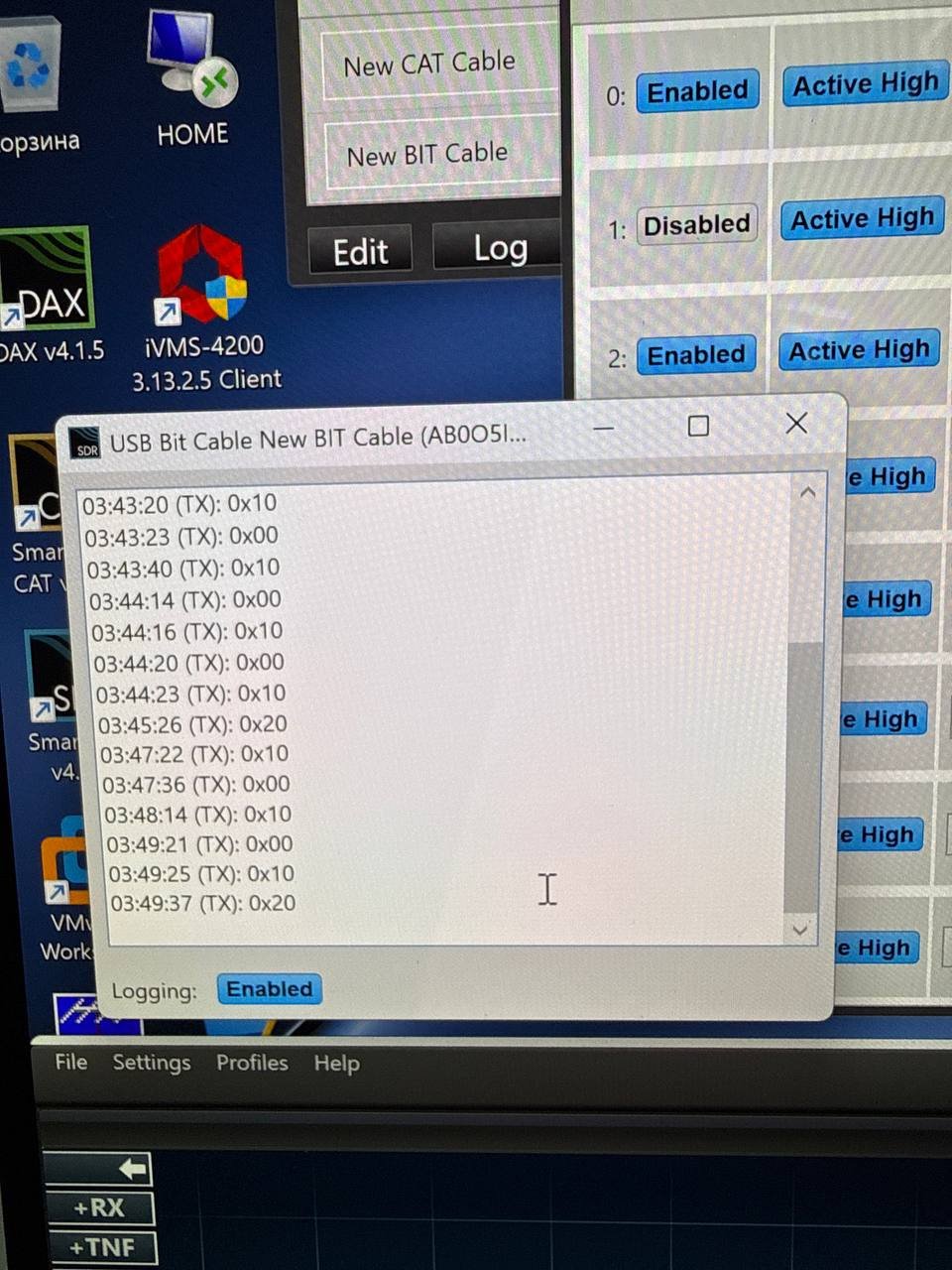

Do the log files show any communication between the radio and the device?
Highlight the Relay Board and then click Log.
Now, test. When you change bands, does the radio send a command to the board? If yes, then the board is defective. If no, then you have a radio issue.
I tried setting up the board like this. The board understands integers, but if I enter the range limits "3.5-3.6," it doesn't work. Here's one screenshot with a working setting: 14-30. And here's a second screenshot with a non-working setting: 3.5-3.6. I'm also attaching a screenshot of the log. The time is shown as US time, not local time. But I don't think this will make a difference.
That is, the program doesn't understand frequencies in kilohertz (for example, 14.1-14.2), but only understands integers like 14-21. I don't yet know how to solve this.
