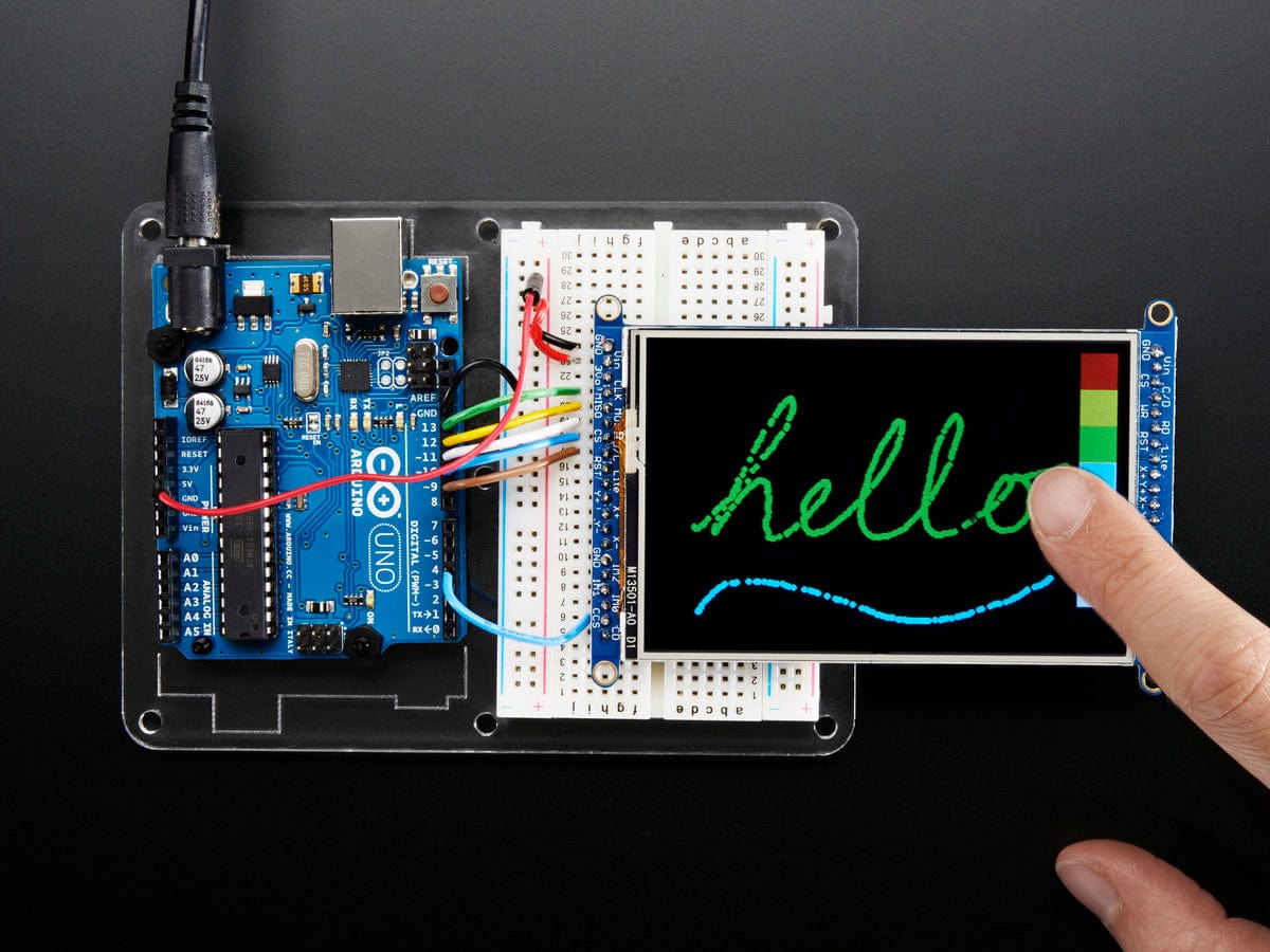

    The Adafruit 3.5" TFT touch display is temporarily unobtanium. If you plan on building a TeensyMaestro, I suggest getting everything else so that you are ready when the display comes available again (Adafruit has given no ETA yet). Adafruit has a "Notify Me" button that will send you an e-mail when the unit is back in stock.
    3.5 TFT 320x480 + Touchscreen Breakout Board w/MicroSD Socket [HXD8357D] : ID 2050 : $39.95 : Adafruit Industries, Unique & fun DIY electronics and kits
    There are several things that the TeensyMaestro can do with no input or output peripherals at all. It has an out of band indicator that puts up a 5 second spot on SmartSDR any time you stray out of band for your license class. You can also set up "permanent" spots to mark band edges, nets, W1AW practice sessions, repeater frequencies, etc. VFO tracking can be turned on so that slice 0 and 1 (usually A & B) will tune by the same amount when tuning in SmartSDR.
    All of this is optional based on config file settings.
    If the display goes permanently out of stock, I will find a suitable replacement and create a version of the software to support it. I doubt this will happen, but you never know...

    Thanks Lasse! Yes, this is the correct display.
  • Member, Super Elmer Moderator
    I just got an email from Adafruit indicating that the displays are back in stock, though in limited quantities.

    I see that Adafruit is out of display boards again, but chicagodist.com (see Lasse's link above) still has 12 available at the same cost.
