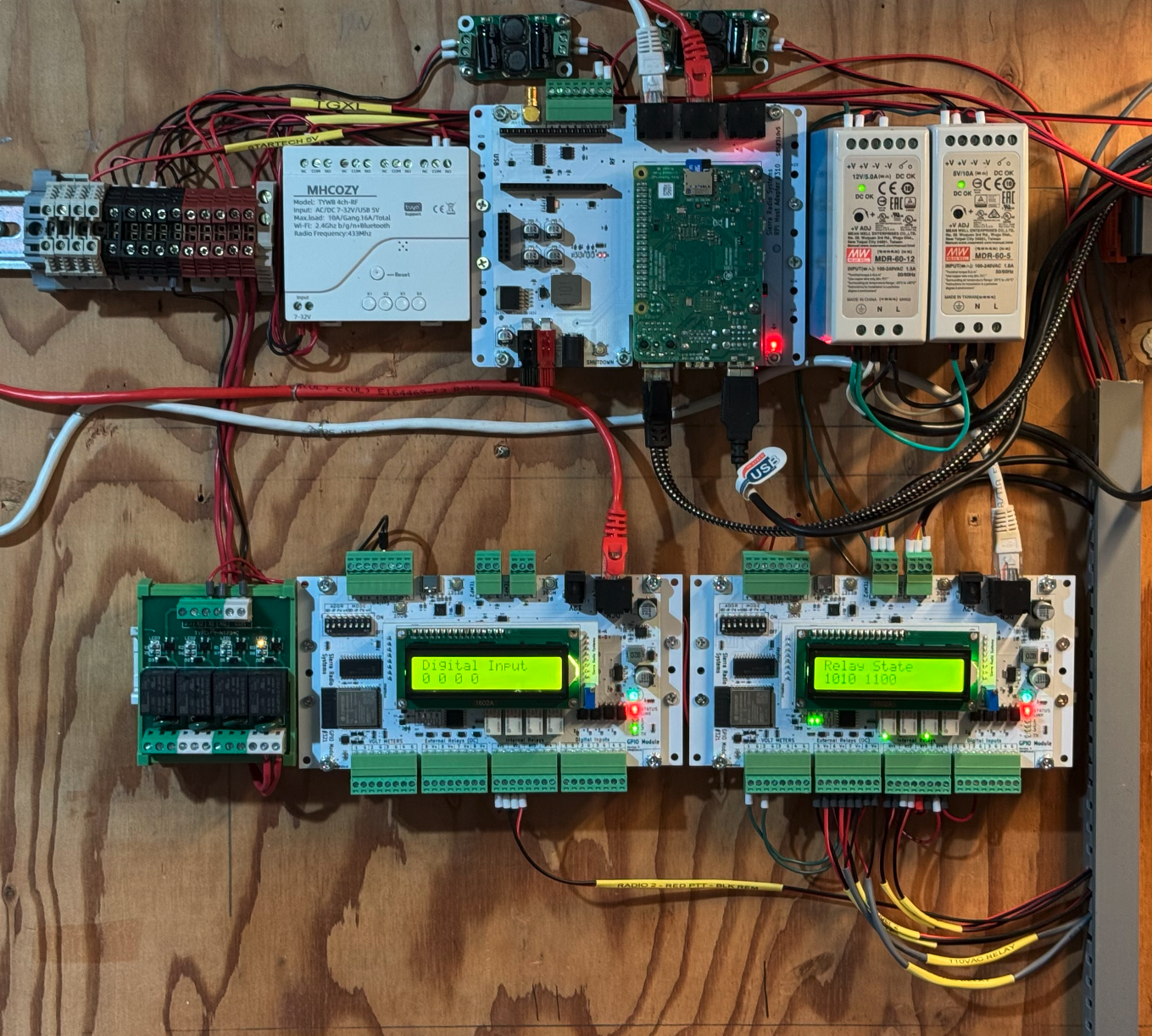

  • Administrator, FlexRadio Employee, Community Manager, Super Elmer, Moderator admin
    I have just rebuilt my remote site to start using Sierra Radio Systems Station Controller. It has a lot of cool things you can do and is very NodeRed friendly. In fact, it runs on NodeRed.
    Yes, it can be a bit overkill… but, why not?
