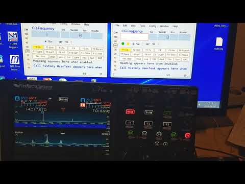

    See my 52 second long YouTube video at the above link for an illustration of what I mean when I say "duplicate sidetone."

    Hi again, I just tested with both SDR 2.2.8 and Maestro. Could not see any difference in performance. It works just as it should. Very efficiently. I was using the external genuin Winkeyer for the CW keying. I plan to write a tutorial for us with screenshots of config menys.
    The difference Tim reported in Maestro I could not repeat after some 130 switching times between slice A and B.
    See a video here:
