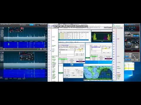

Hello,
during the we, as I am too far away from Dayton (HI HI), I developed a small utility that supports OTRSP protocol.
I like very much 5MContest, a russian contest software, that, for what I know, doesn't support OTRSP.
My program simply monitor the active (focused) window switching from Radio 1 to Radio 2 as the operator select the related window. It can also configure audio to listen only to the TX focused window, or it can select Stereo or RevStereo audio mode. Configuration is quite simple: you need to set up the beginning text of each window title and the serial port that supports the OTRSP protocol. Actually you can use it with each rig that supports OTRSP protocol and each contest software that uses a separate window for Radio 1 and Radio 2.
I appreciate a lot the SO2R switching imprevement of 2.2.8 release as well.
