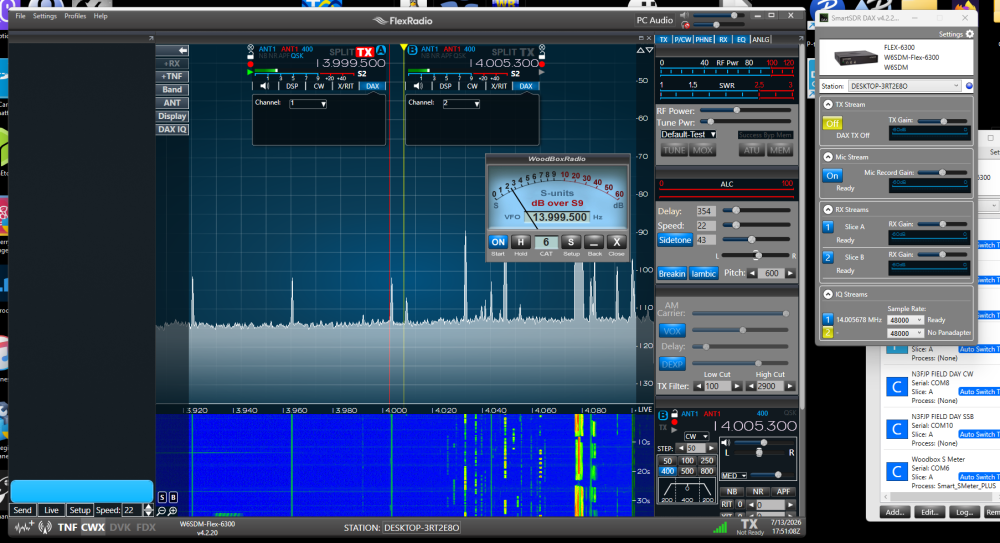

I'm using a Flex 6300, SmartSDR 4.2.2, Windows 11. I am not getting any indication of audio on the DAX panel. Also, if I click on the ON or OFF buttons, I get no response. When I select DAX channel 1, the button changes to Blue. It also does this on Slice B. I can hear the audio, and if I attach a Woodbox external S-meter, it works, but not the Flex S-meter.
Any help would be appreciated.
Steve, W6SDM
Oh, and I forgot to say that I did a SmartSDR download and repair, and power cycled both the radio and the computer.
Mike-VA3MW Administrator, FlexRadio Employee, Community Manager, Super Elmer, Moderator adminOptionsYou only get an audio level reading when it is connected to the application you are using it for.
This is a change in DAXv2.
