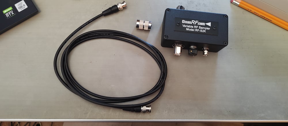

I got my CleanRF.com -60 dB RF sampler yesterday (ordered Thursday evening).

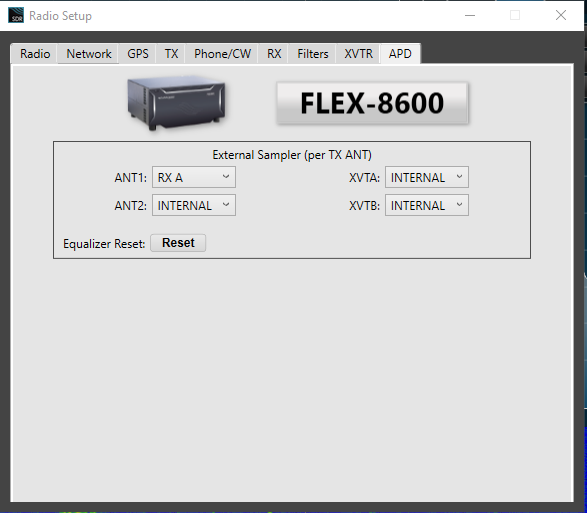

I have it connected to my KPA 500 with the RF tap going to RXA. I set it up as follows:
I tested it in Full Duplex (FDX) by opening a second panadapter, putting the second slice RX on my dummy load, while transmitting into my antenna. With APD off, I could see a few artifacts from the amp. With APD engaged, it was very clean. This is just a visual qualitative assessment, not a quantitative one, but it clearly shows signal purity improvement.
