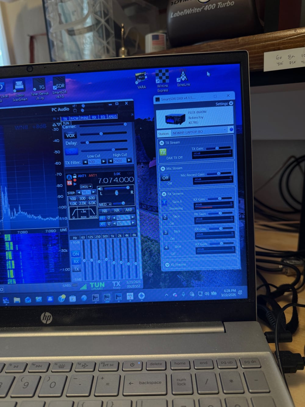

Yellow "TX" button in DAX
You need to turn on DAX for transmit:
That got it, at least my FT8 is working. Still no VaraHF though. Thoughts?

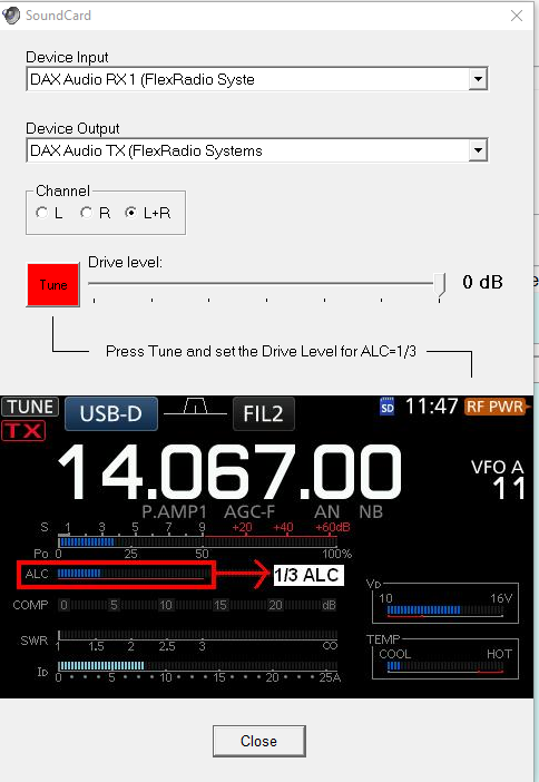

As far as VarAC goes, in the VARA HF settings, choose these DAX input and output devices:

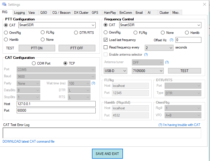

In VarAC Settings, Rig Control and VARA Configuration, select SmartSDR for PTT and Frequency Control. Select TCP for CAT Configuration and the values I show below for Host and Port.
There are probably other things that I am not thinking of, but that should get you started.

Im using VARA HF. Not same screens regretfully..
VARA HF is just the HF modem. VarAC is the communication program that uses VARA HF.
Here is a link:
On my old radio (IC7300) I used Winlink and VARA hF, nothing more.
Ah, Winlink. I thought you were trying to use VARA HF by itself.
Thank you all, I got it working !! Just in time for the Wyoming Winlink exercise….
