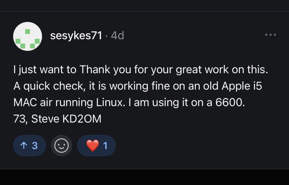

Hey Mike, there’s a discussion thead on the repo titled “AtherSDR” where Steve, KD2OM reports having Linux on an older Mac and it working. You might try replying and asking about his setup.
