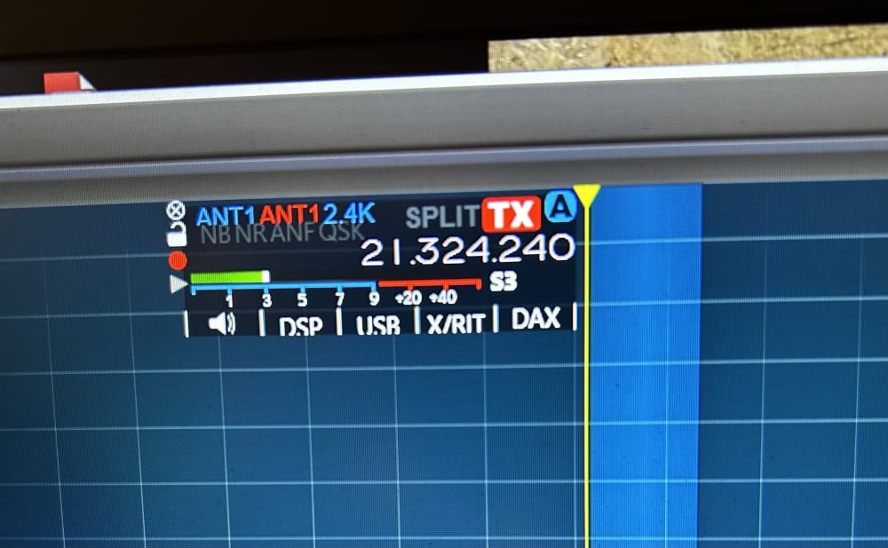

I just installed 4.1.5 on Windows 10 and it’s working fine, however, the bottom part of the flag is missing. Any thoughts how to fix this (see photo)?

Hi Scott, it looks like a font issue, but you might want to try a factory reset to see if that fixes it. Be sure to export your profiles first.

You may have tried this but click on A then click on A again. Probably not the cure but something simple to try.
Check this link for more info:
https://community.flexradio.com/discussion/comment/20480678#Comment_20480678?utm_source=community-search&utm_medium=organic-search&utm_term=font
Thanks for the suggestions guys.
I installed the fonts and took down the windows font size (per the article) and it looks like that fixed it.
