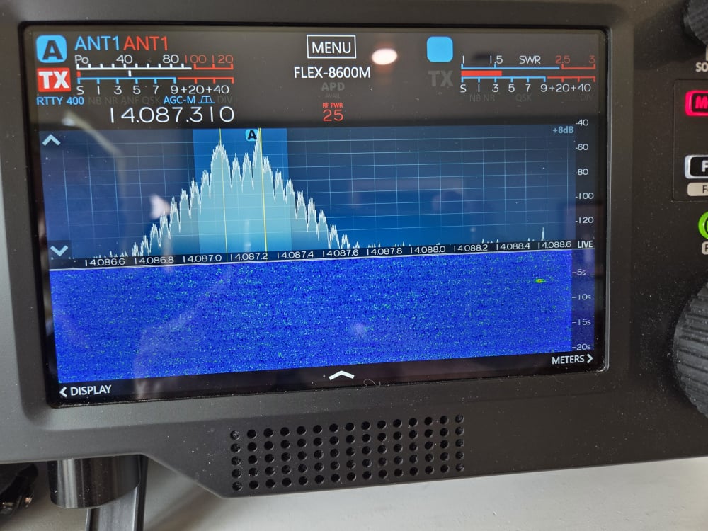

I seem to be producing a impure rtty signal from my 8600M with v 4.1.5
. I have the DAX TX stream set at the suggested 45, the mic set on RTTY Default. Ideas? Thanks, Roger
Mike-VA3MW Administrator, FlexRadio Employee, Community Manager, Super Elmer, Moderator adminOptionsthat is before the RF filtering in the radio.
Start a 2nd slice with a different receive antenna and put the radio in full duplex (FDX) and you will see it is much cleaner.
Also, make sure you are not overdriving the radio. Can you post a picture of your LEVEL meter?
