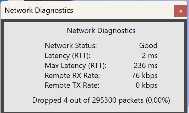

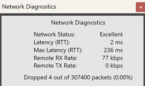

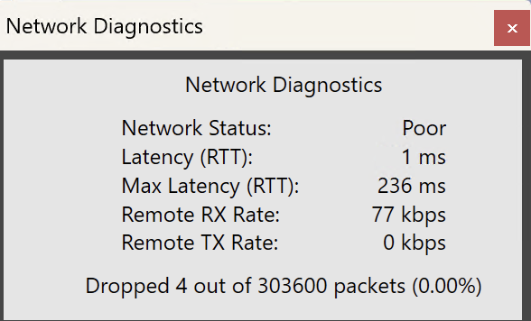

    So I've invested in a managed switch and set the 6600M's port to 100/Full. I've also purchased CAT 8 shielded patch cabled for every device. While I'm not seeing the operational impacts (delayed or no PTT), I do see the network quality (according to SSDR) varying wildly. Further, I'm having difficulty understanding the criteria used to determine the quality of the network. It almost seems arbitrary. Latency is low, packet loss seems to be a single event at SSDR startup, and the max latency hasn't changed.
    Does anyone know how this diagnostic works?
