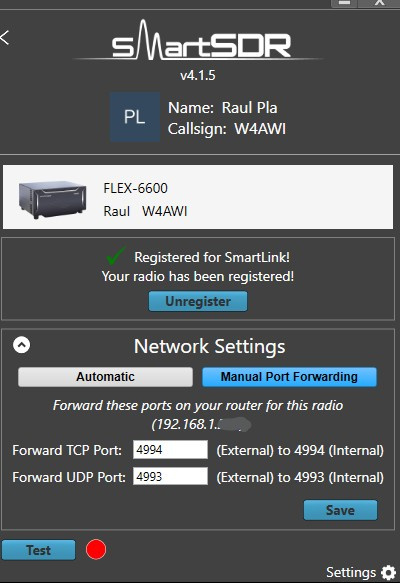

Smartlink Network Settings Help Wanted
Im setting up Smartlink for the first time. If I choose Automatic port it just shows a -1. What number should I put for TCP and UDP ports under Manual Port Forwarding? I can log into and have access to my AT&T home modem/router/access point combo device..
I have the same issue at my work QTH with a Comcast combo device. Planning to use Maestro to remote into each location. There is a Flexradio at each location.
Ive search for a manual in Flexradio and Youtube and cant find this info I need.
Appreciate any help. 73
Ive set up the router to pass through and it was already UPnP. Anything connected to it will work. The Smartlink, after hours of router config changes will not test green. I even made a tunnel for the radio. It seems that the radio and smartlink are 2 different devices in some. At this point I need to find help, hire help, whatever these needs.
