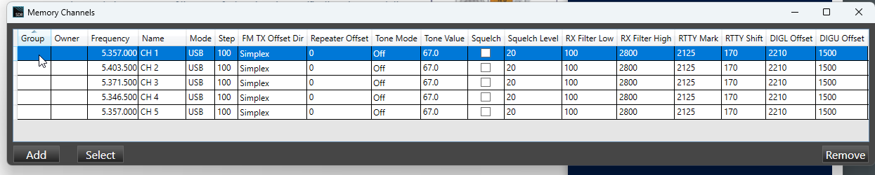

This might help. I took a FLEX-6600, installed 4.1.3 on it and reset the radio. The High Cut is critical in that it has to be less than 3000Hz as more than that puts you out of band.
I then added the 'current' 5 channels for a typical US TURFing. This does not reflect the new 60M law that just was changed.
I then exported the memories to a ZIP file. You'll need to extract it and then import it Import/Export Profile utility (within SmartSDR).
I confirmed that the radio does TX on these 5 channels.

I think you are missing 5330.5. Not sure of the order, but it is the lowerst frequency channel.
I usually number the channels from low to high frequency but I may be wrong…
https://www.arrl.org/60m-channel-allocation
Hmm ... I entered the 5 channels that Mike shared in the spreadsheet he attached.
Channel 1 is the same as Channel 5
LOL … I hadn't noticed that.
Mike VA3MW —> You need to update the spreadsheet :-)
I changed CH1 to 5330.5 and it works fine, and all 5 channels are in and working.
