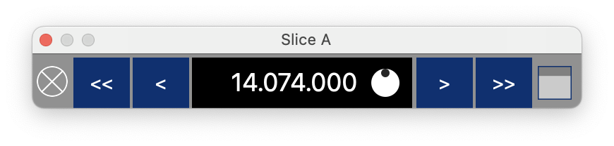

I'm getting up to speed on SmartSDR for Mac. So far, the FlexControl doesn't work. Now I've tried the Icom RC-28, which is a very nice device. It does work, but the default tuning rate is far - FAR too fast. I've tried to find where the tuning rate can be adjusted. In the manual, there is this:
However, I cannot find this device anywhere even after searching every menu. If it's here, I cannot find it. Right now, I'm pretty frustrated with this software.
I don't have the RC-28 but you can control the tuning rate, in general, by setting the step-size parameter for each slice. Mouse and Trackpad have separate settings for sensitivity should you revert to those tuning devices.

It's in the next line below this one, on the far right…where it says STEP.
