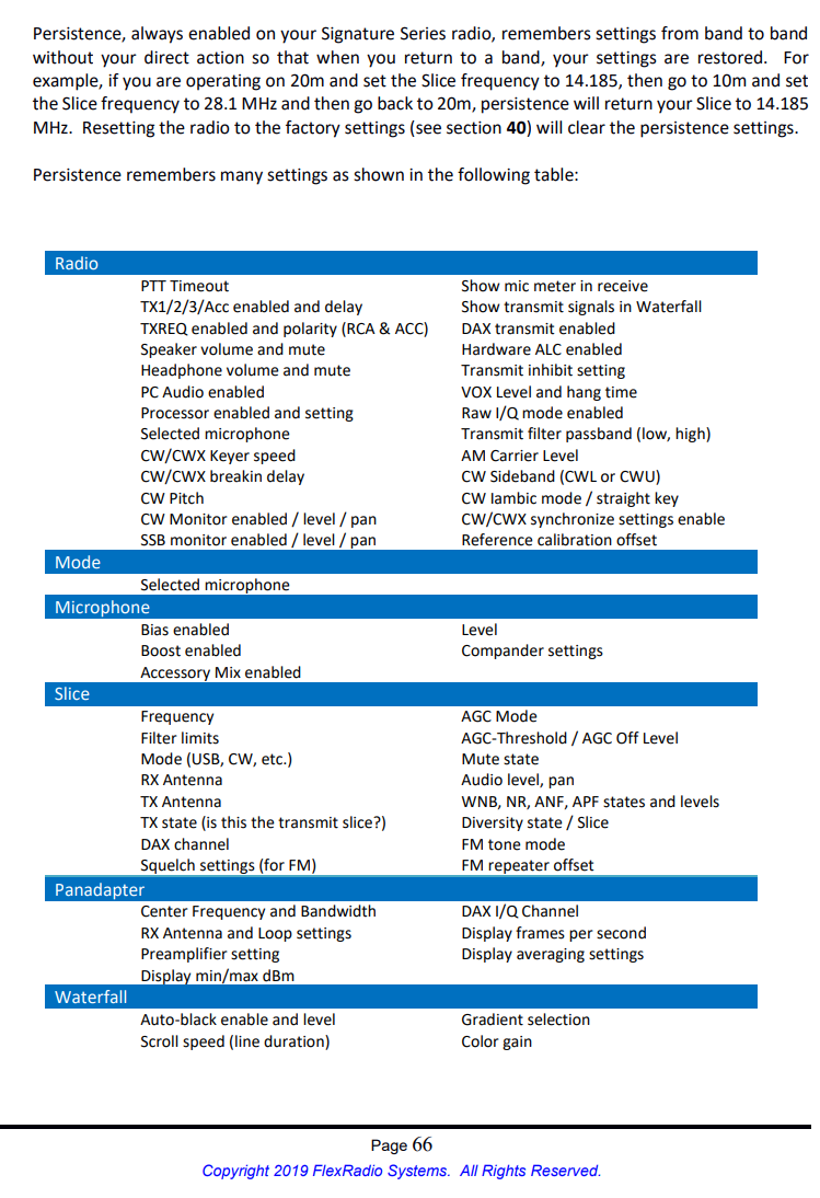

I just discovered (quite by accident) that the +20db mic preamp setting in the Settings/Radio Setup/Phone-CW panel is not persistent. (I had always believed that all the settings in the Settings/Radio Setup panel were.) It's necessary to save it to the microphone profile.
Mike-VA3MW Administrator, FlexRadio Employee, Community Manager, Super Elmer, Moderator adminOptionsIt should be persistent.
Is there any chance you are changing Mic profiles? Page 70 shows the settings that are saved by the MIC profile.
Theses are the settings saved by persistence.
See if you can see what is changing.
