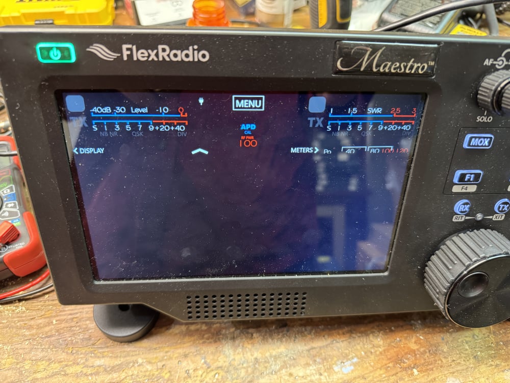

When I try to connect with the Maestro, all proceeds normally, to a point.
If the radio is not in use at the station (i.e., by the station computer running SmartSDR), Maestro gives me the Select Radio screen, showing my station (via Smartlink). I select it and click Connect, leading to the Select a Version screen. I picked v4.01 (which is installed on the Flex6500) and click Run. Then, the Maestro screen shows the top inch or so of the radio UI, with the S meter, etc (see attached picture). But nothing else. I can't see the spectrum display, I get no audio, pressing Tune does not seem to do anything, etc., etc., etc. It's frozen.
If I am connected to the radio by SmartSDR on the computer at the station (accessed by from home by Anydesk), and I try to connect with the Maestro at home, I am given the Select Radio screen, showing the station (via Smartlink) and, in paren, multiFLEX - indicating the ongoing session between the radio and SmartSDR at the radio location. When I click Connect, I get to Select a Version. I choose v4.0.1 and click Run. The Maestro screen again shows the top inch or so of the radio UI - inoperative as described above and shown in the picture. My instance of SmartSDR at the radio station (which I'm accessing from home via Anydesk) freezes for a bit (audio interrupted ~10 sec) and I see - on my home Anydesk view of the radio station SmartSDR session, two transient connection notifications from the Flex software: one saying Client connected from IP 97.xx.xx.xx (which I understand is the attempted Maestro session), and another notification soon following saying Client connected from IP 10.xx.xx.xx (which is my pre-existing SmartSDR session on the computer at the station, resuming, at which point audio is restored, etc). The Maestro is frozen with the top part of the UI showing, while I can continue to use the SmartSDR session on the station computer via Anydesk. (When I later shut down the SmartSDR session on the station computer, I find a window "SmartSDR for Windows has lost connection to the radio - please reconnect," which I presume was triggered when the connection from the Maestro was attempted.
