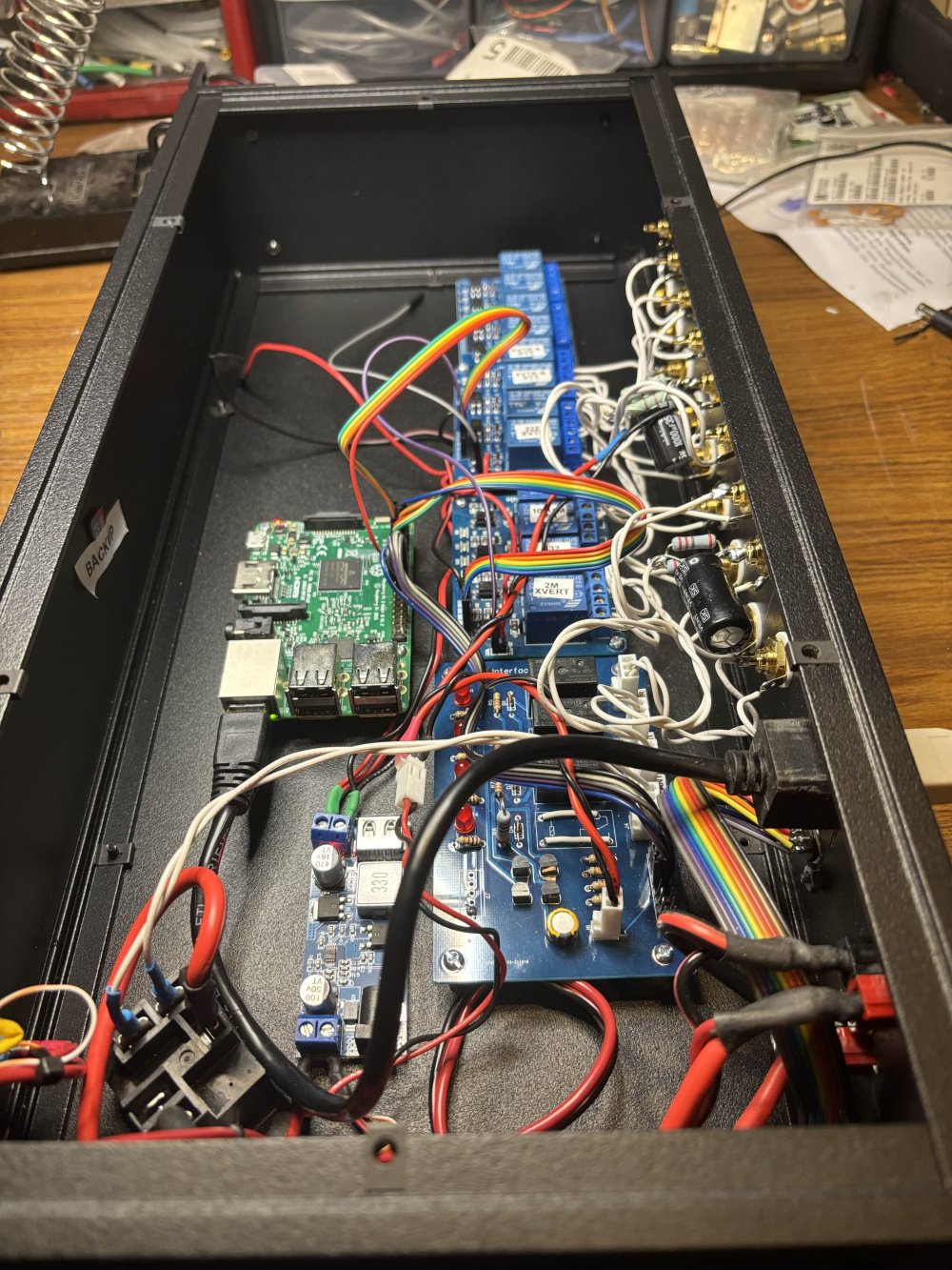

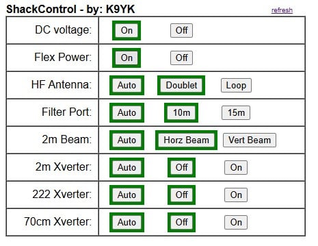

I have a RPi that connects to the API and controls a whole bunch of things in the shack (think Node Red, but all my own code). It also supports manual overrides for any of the automatic/radio following rules. I tried using a bit cable once a while ago, but the configuration options in SSDR for the bit cable didn't support all of my use cases (plus no manual overrides either).

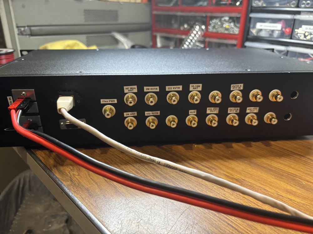

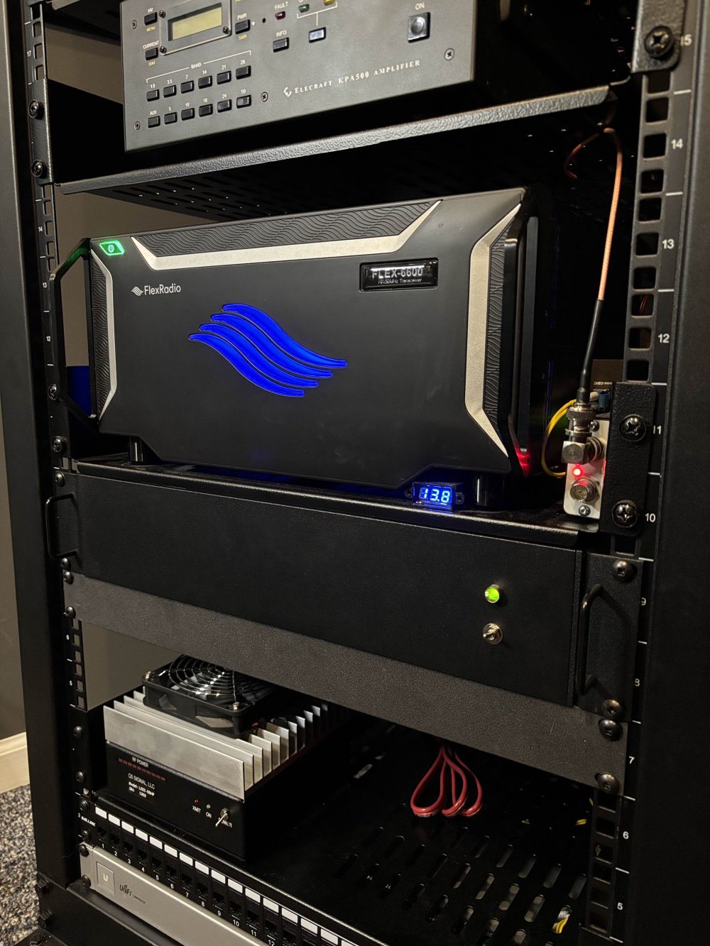

It sits in the rack just below the 6600.
