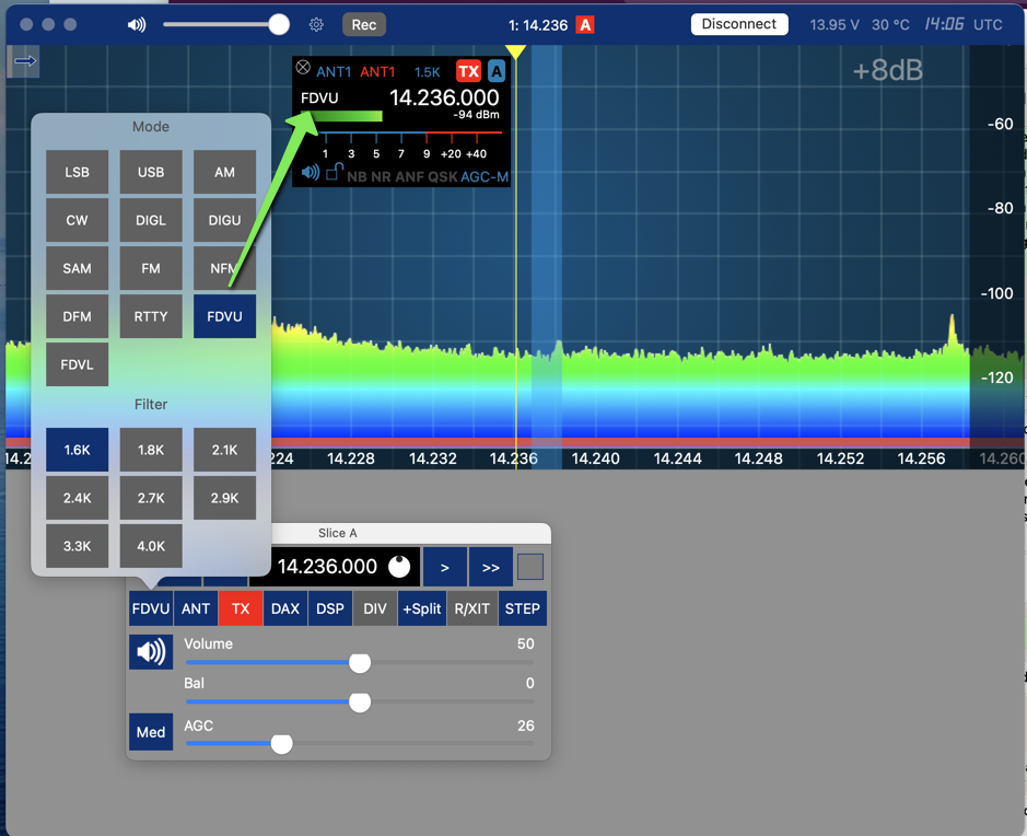

5. Using FreeDV in SmartSDR
Once the AppImage is running and connected to your radio, FreeDV modes will appear in SmartSDR just like any other mode:
- FDVU
- FDVL
You can select them from the mode dropdown on a slice. Set up your Mic levels as you would on SSB.

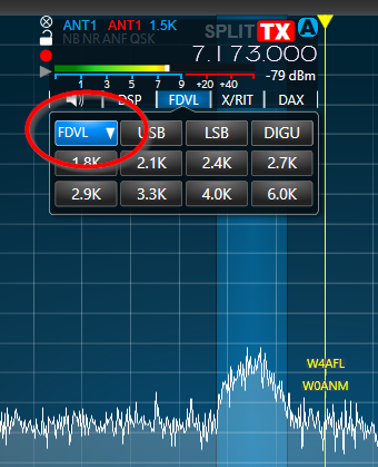

FDVL (filter change) causes them to switch to upper side band on 40,80,160 just like the wave form issue of the past. Reared its ugly head again.
