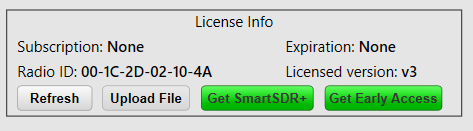

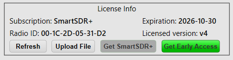

Open up Radio Setup (via Settings, Radio Setup). At the bottom of the Radio Setup in the License Info section it will say what you are subscribed to. See screenshots below, the first one shows a 6700 licensed for v3 but with SmartSDR Basic v4.01 installed. The 2nd screenshot is the 8600 subscribed to SmartSDR+ v4.01

Hi Mike,
Thanks. It does answer the question, I am still listed as v3. Will it only show v4 if I subscribe to one of the two higher tiers?
Pierre VE3KTB
Yes Pierre, once you buy a license for either SmartSDR+ or SmartSDR+ Early Access it will show that in the Licensed Version field and will also show when the 365 day license expires in the Expiration field.
I have an additional question on this matter but a different issue. I have decided to remain on v4.01 basic for the time being. I understand the upgrade to version 4.0 is free of charge. I was previously licensed to v3.0 and the "radio setup" page in the settings tab reflects that and I am not seeing any change on that after upgrading to the free v4.01 basic. Since v4.01 basic is free of charge, shouldn't my "radio setup" page state v4 following the "Licensed version" field or does that entry only reflect that last purchased version of SSDR ? It appears to be the latter . Just curious.
Mike-VA3MW Administrator, FlexRadio Employee, Community Manager, Super Elmer, Moderator adminOptionsIt should show a maxed version of v4. If it doesn't open a support ticked and we can look into it for you.
Here is my 6700 with the full Radio Setup screenshot with v4.01 Basic. The HW Version field shows v4.01.3961 and the License Info section at the bottom will show what the radio is licensed for, in my case the License version field shows v3, not v4 because it is not licensed for v4.
