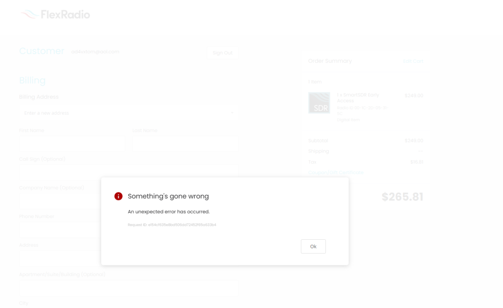

I have installed 4.0.1 on my 8600 and have attempted multiple times to subscribe to SmartSDR+ and even the early access. Every time, I receive the following error:
-Tom W9TO

Hi Tom, does your radio have Internet access? If that's not the issue, submit a help desk ticket.
Len is correct. How is your radio connected to your home network?
Mike (VA3MW), My PC is connected thru WiFi, so recently I have inserted a router between my Windows PC and 8600. Is that sufficient?
-Tom W9TO
Mike, I should add that I did download and install 4.0.1.
Mike, Sorry, it's all on me. I use Norton AntiTrack and it was stopping the interface with my computer. Once I turned that off, I was able to order and receive SDR+ Early Release.
-Tom, W9TO
