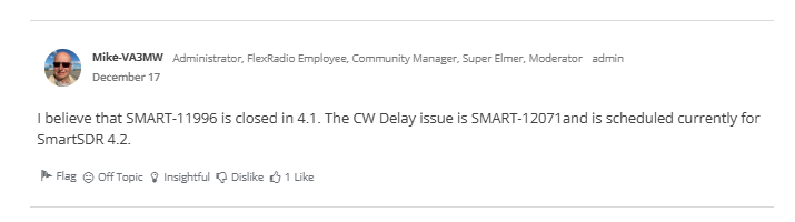

Just loaded 4.1.5. The delay is still there. Hopefully the software folks will get SMART-11996 resolved in the next release.
Rich - N5ZC
Without breaking out any measuring tools, it appears to be working on my end with 4.1.5
From this thread
https://community.flexradio.com/discussion/8032580/smartsdr-v4-0-1-basic-how-do-you-adjust-nb-nr-settings#latest
It's due to be fixed in 4.2
