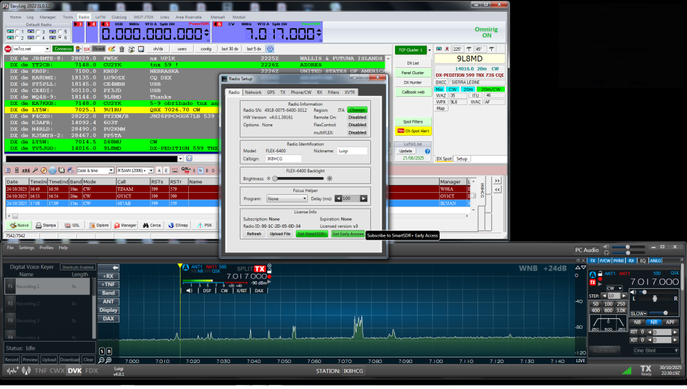

    i read this
    Important Notice: Beginning with SmartSDR v3.10.10, the SmartSDR hardware license installed on your radio must be
    revalidated by connecting to the SmartSDR License Server. To complete this process, ensure that your radio is connected
    to a network with Internet access. Once your SmartSDR license has been successfully validated, the radio will not need to
    reconnect to the License Server unless you purchase a new SmartSDR+ feature license.
    serial 4918 0075 6400 3012
    Now I'm wondering if the new features I downloaded in version 4 aren't active. Is that right?
    11.png 445.9K
  • Erik Carling EI4KF
    edited October 2025
    In V4 Basic, NR and ANF have been "improved with an updated algorithm". So those are 'active' but nothing else is right now without a SmartSDR+ license. For example, the DVK that you opened will never work without paying for it.
