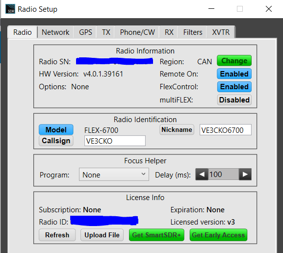

For me v4.01 installed on both my 8600 and 6700 was easy with no issues, and I did shutdown, disconnect power to radio etc. as per cold start instructions. Getting SmartSDR+ license was a breeze, refer to screenshot below, just click on what you want Get SmartSDR+ or Get SmartSDR+ Early Access. Choosing SmartSDR+ it brings you to payment page, you can sign in if you have a FlexRadio account. The cost for SmartSDR+ was discounted $50 to $149 and and after submitting payment, you go back to the Radio Setup and a message at the bottom will say "Click the 'Refresh' button in the menu after checkout". After clicking the 'Refresh' button, within a couple seconds SmartSDR+ was licensed to my radio.

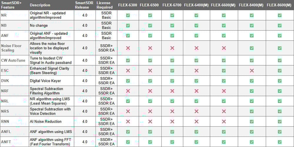

I looked at the feature chart supplied by FlexRadio and provided below for your convenience, and I've confirmed it is accurate as to what feature available or not for the 6700 and 8600.

    The chart doesn't make that very clear. I have read a post where the person upgraded to SmartSDR + and was able to use the Allow noise floor to be seen visually feature . I think if the column has both SmartSDR + and Early Access listed, that should mean it is available at once to both subscription types at the same time. Otherwise, there should be an indicator of some kind that makes it clear that only the Early Access subscribers have access to the particular feature. And a notation that it will be available to SmartSDR +subscribers 30 days later. Otherwise, the table is confusing.

    I agree James. Both Noise Floor Scaling and ESC are available now with SmartSDR+ and the chart does not differentiate it has SSDR+ and SSDR EA for all new features. I found out the hard way by hunting down each feature.
    The Licence Required should be modified to say 'SSDR+ in 30days' for those features that are only available for Early Access.
  • Gord-VA7GP
    Yeah, I guess I missed the "wait 30 days for EA trickle-down"…
    SSDR+ and SSDR+ EA get the same features. SSDR+ EA users get it 30 days earlier. This is why the chart shows both in the feature row.
  • Mike VE3CKO
    I understand that the Licensed Require column shows both SmartSDR+ and SmartSDR+ Early Access and by definition Early Access means all those features are usable immediately for Early Access, and then 30 days later, they kick in for SmarSDR+.
    Where the confusion is the chart does not indicate what features are immediately available for SmartSDR+ and what features for SmartSDR+ that are not available for 30 days.
    According to that logic and the chart both ESC and Noise Floor Scaling should not be available with just SmartSDR+ but as in my original post, I have found both ESC and Noise Floor Scaling are indeed available immediately for just SmartSDR+. See what I mean?
    Not complaining at all, in fact this chart is a great tool to effectively show coming features and I hope a chart like this is pre-released for all future releases, very well done but needs just a bit of fine tuning.
