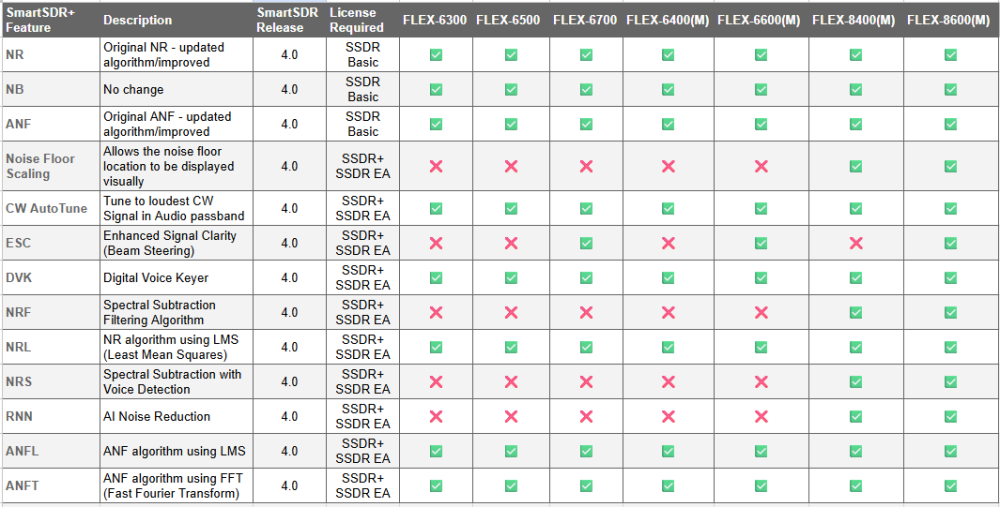

    I am glad I am not the only one confused. I have rebooted, factory reset, reinstalled, re-read the installation notes, checked Mike's table of features. I conclude that only NR, NB and APF are available. I opened a Ticket but then closed it thinking it was me, maybe early senile dementia. But now I wonder. Len, when you receive clarification please publish the facts of it. Thanks.

    I was not referencing diversity. I am showing the NRL noise reduction button which is supposed to work on a 6400.

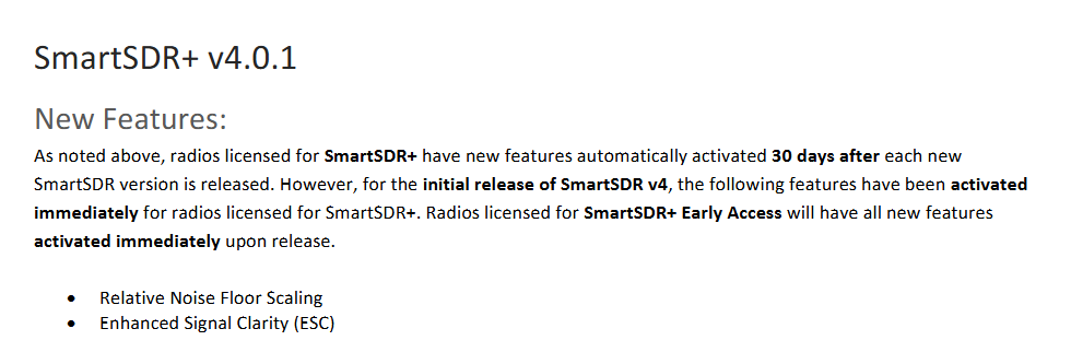

    Eric,
    I think this is covered in the release notes, but maybe I am missing something. Can you clarify a bit and maybe we can sort it out.
  • Erik Carling EI4KF
    You are not missing something. It is that the features list is inexplicit as to what is available on the initial release and what is not, which is everything except noise floor adjustment if you have only the 8400(M). The preceding paragraph that you note above is being overlooked by many, most even, and hence the confusion.
    KD0RC Moderator
    Hi Mike, I saw that, and the complete list is just below, so it looks like the whole feature set is available now.

    I upgraded my 8400 to the SmartSDR+ and all the new New DSP Noise Mitigation are still grayed out. I put in a support ticket for this problem. Heard nothing back yet!
    KD0RC Moderator
    Hi Ken, As a SmartSDR+ user you won't get the new functionality until 30 days after the release date. This gives the Early Access purchasers a 30 day head start (they pay extra for this privilege).
