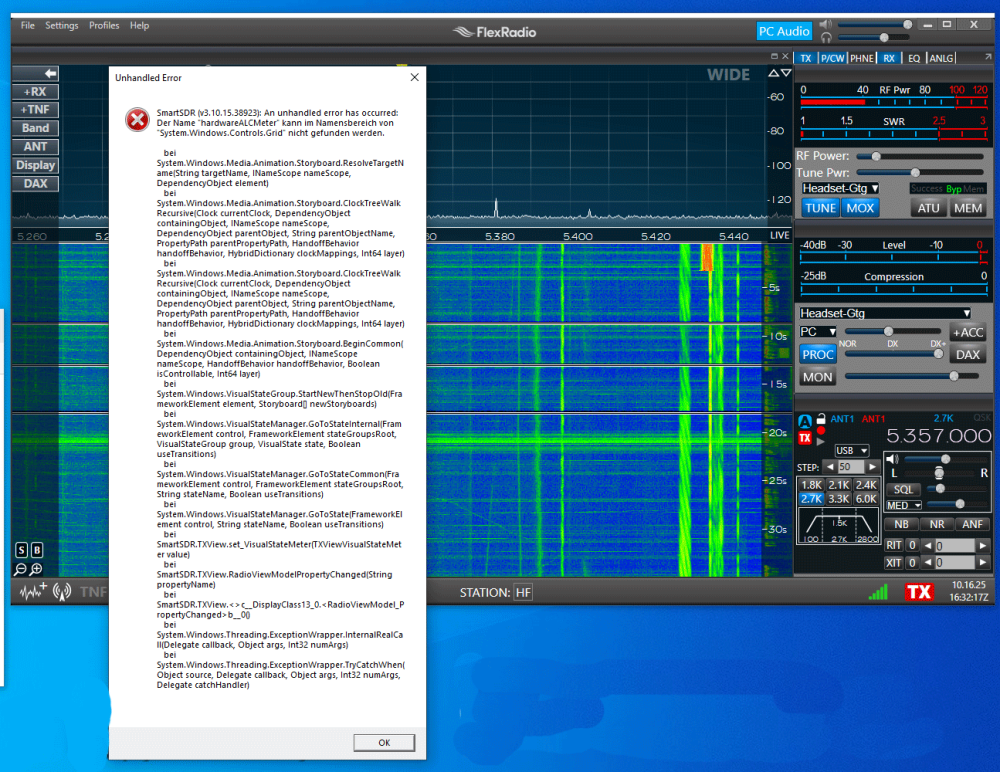

Hello,
I reported several versions ago that SmartSDR for Windows crashes immediately when using HWALC.
Fixing this very dangerous bug doesn't seem to be that important to Flexradio.
73, Hardy

I described the error in detail and reported it to support.
There's nothing more I can do other than wait...
@Mike:
You need to enable hardware ALC, and then an ALC voltage must actually be present.The error is the same on four PCs – Windows 10 and Windows 11 – the Maestro (A) is not affected!
Mike-VA3MW Administrator, FlexRadio Employee, Community Manager, Super Elmer, Moderator adminOptionsGot it. Make sure that is clear in your support ticket. I know we do not have an amplifier that has a hardware ALC line, but we could easily enough test it with a voltage divider and a 9v battery.
I can confirm the issue is present, I have exactly same issue on latest SmartSDR.
