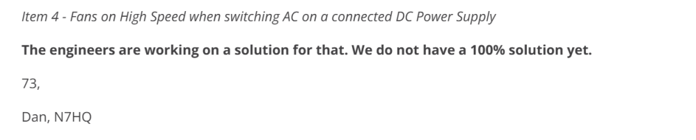

The question: from a posting on this Forum in 2021, there is this which relates to my issue
When I turned off my TGXL yesterday I did so at the wall socket for the PSU. On power up this morning the fans ran at full speed and would not stop. Has this issue been fixed in the past 4 years please and, if so, what do I need to do? The FW is 1.2.17

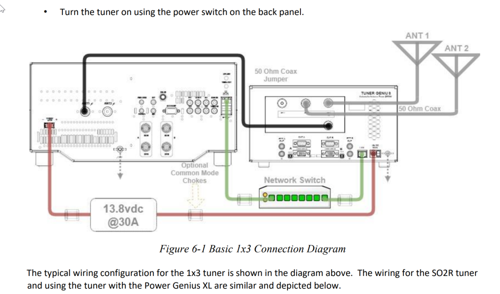

OK thank you, Mike. I was misled by reading the manual which told me to use 13.8V
I will acquire a 18VDC wallwart.
Erik.

In the interim 4 years since Dan asserted that the issue was being worked on by engineers, could there not have been a FW revision to terminate the fan in such a scenario? Evidently not.
But anyway, hello Alan and thank you. I will do that (start PSU then TGXL). I can easily reach and find the on/off switch even in spite of its remarkably tiny size.

It saddens me that the TGXL is not 12v-compliant, to work harmoniously with all other ham gear 😕
When I saw 13.8V in the TG user manual I thought 'excellent, wire the supplied lead to the shack power supply along with the 8400M'. This morning, already similarly saddened as you are Gord, a mains power outage (one of many we get here). Later whilst outside in the yard, the XYL comes running out (slight overstatement) to me "there is a horrendous noise from your radios". Power had been restored and the TGXL was doing its best to resemble an aircraft at take-off. So, the 18V PSU will fix that but surely is this the best 4O3A can do? Now saddened and exasperated🤒. It is still an excellent piece of kit and I love it really.
