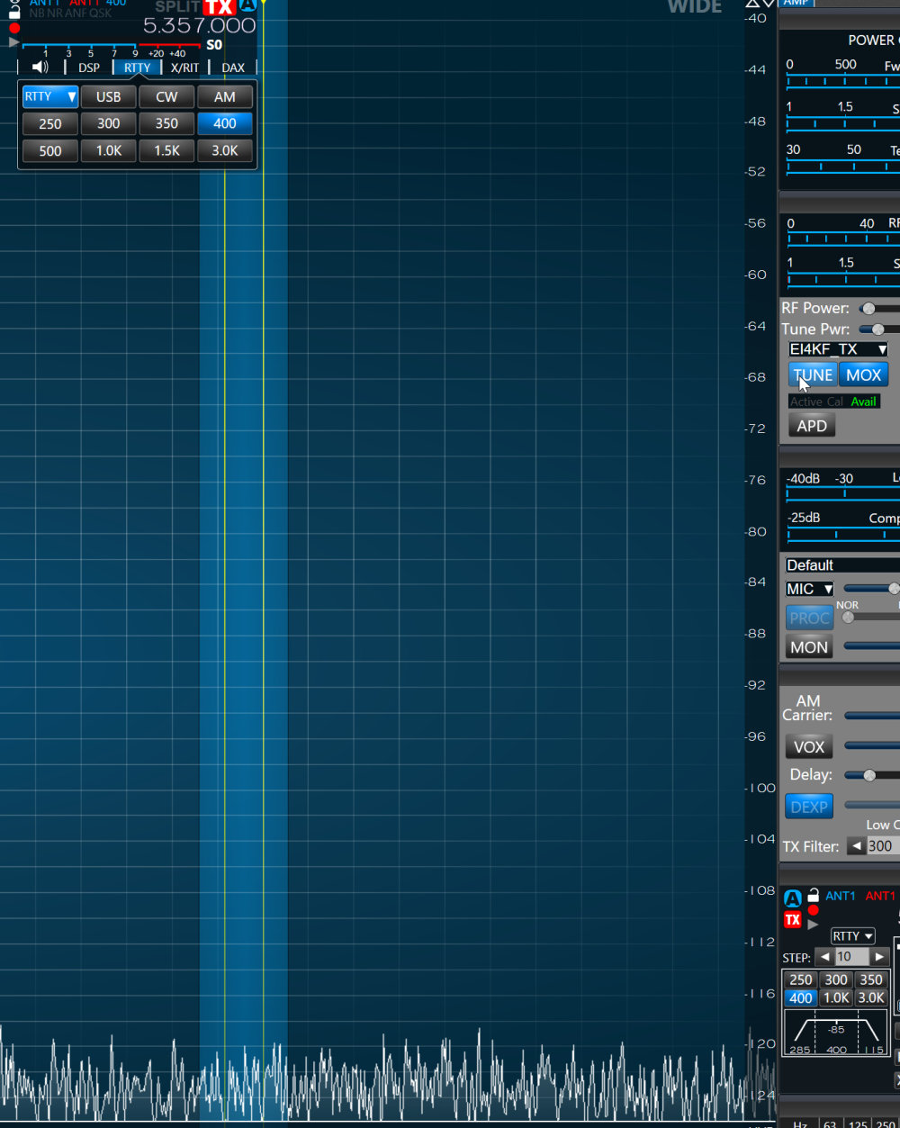

Should I be able to tune in RTTY mode?

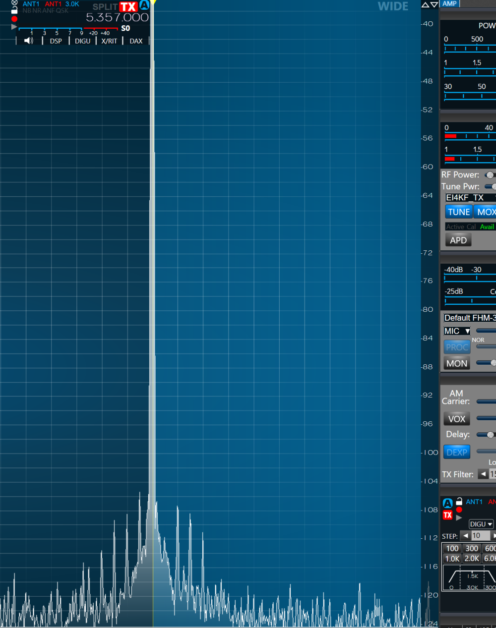

In all modes except RTTY, going into Tune produces a carrier as expected.
However, as I found out in CQ WW RTTY Test this past weekend, in RTTY mode it is not possible to Tune.
There is no output from the radio.
Some versions ago, Tune worked fine in RTTY. Then there was a bug introduced where, although Tune worked, the carrier was +2kHz from the dial frequency. In 3.9.19 there is no Tune at all. Should it be like this?

    Yes John, DAX is on. The issue is not DAX related but mode related. With same settings and working in SSB, CW, DIGU etc there is no Tune in RTTY.
    Erik.
