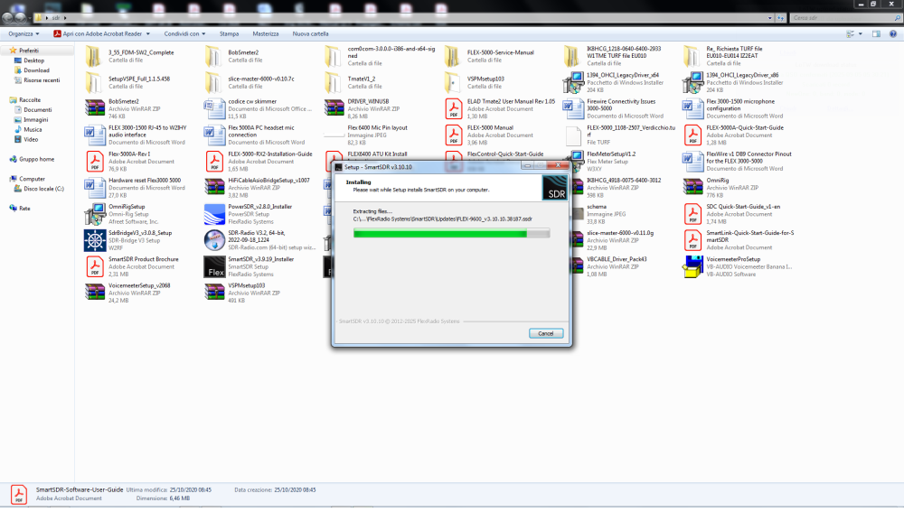

    As I wrote, I downloaded version 3.10.10 directly from the download page https://www.flexradio.com/software/smartsdr-v3-10-10/, and loaded it onto my PC. When I turned on the flex and launched SSDR, it showed me version 3.9.19.

    I thought the update would overwrite la 3.9.19. Anyway, after downloading it and not seeing it on the SSDR, I uninstalled it.

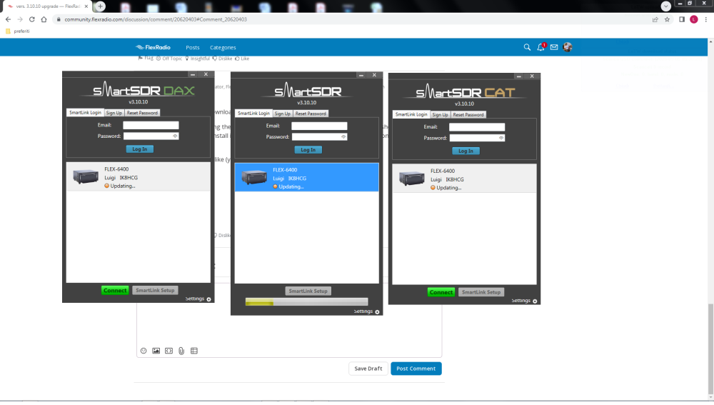

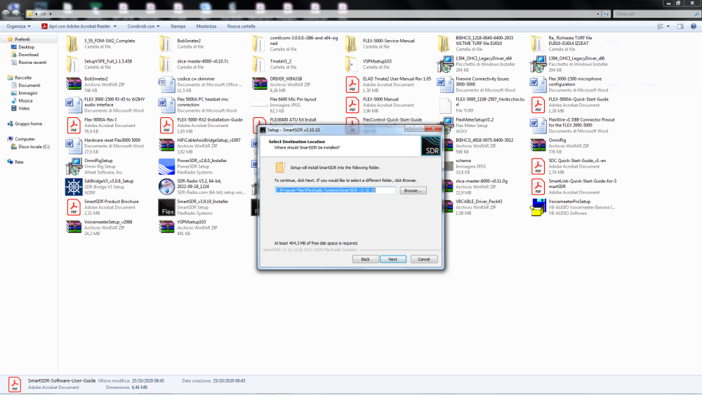

    I think I solved it. Did I have to do it with the flex on? Now the update appears.
    now ok
    no need to have the radio on until you update the software on the radio.

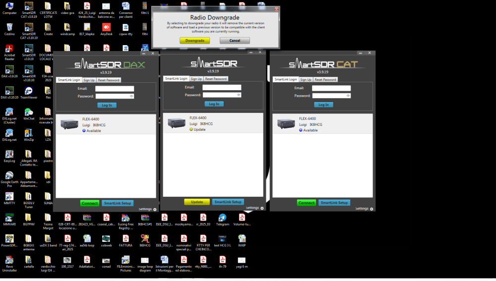

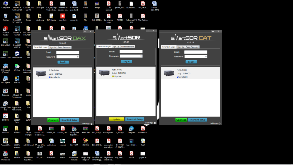

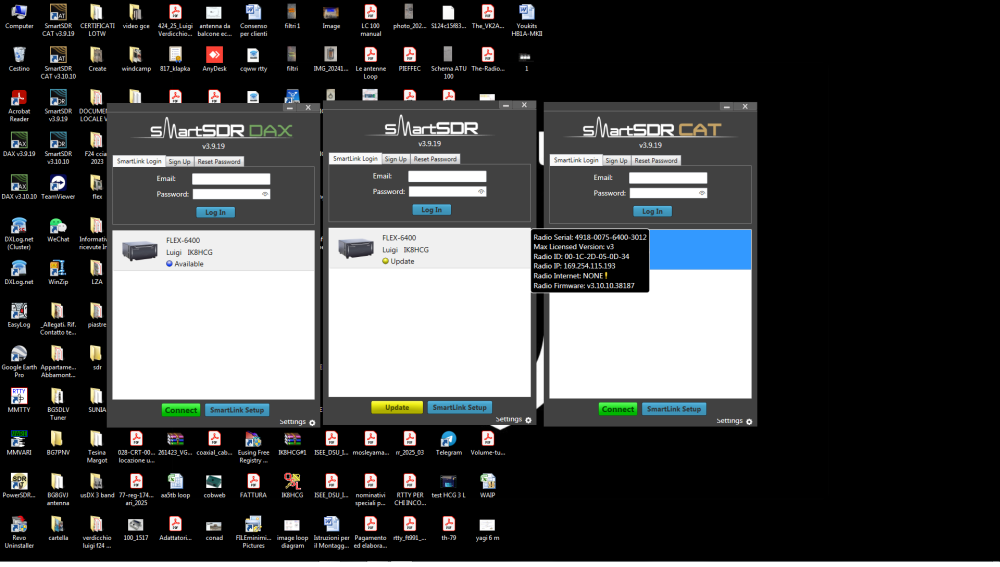

    I don't understand what the problem is, today I upgraded to 3.10 and now as soon as I launch the program it appears as in the photo without being able to turn on the radio

    It look as though you are launching v3.9.19 not 3.10.10. Is shows the radio has 3.10.10 but the software you are loading is 3.9.19.

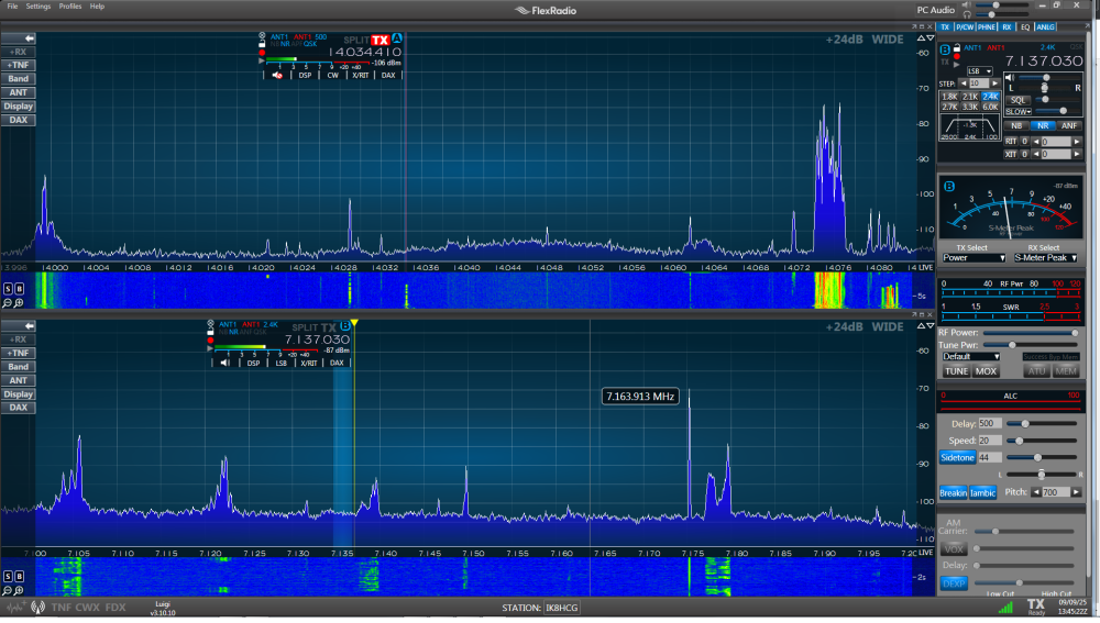

    Today I successfully downloaded 3.10, and if you see the photos above, it didn't give me any problems, although I had a problem with the first download of v.3.10. This evening I turned it on and it looked like the photo. I don't know if I should downgrade, as I can't run the ssdr right now.
    in the black window I read version 3.10

    Yes, that is the Radio 3.10.10. You must run the same version of the software. Look at the version of the software you are trying to run:

    i try to downgrade
    I downgraded, and now everything works. The 6400 is operational, but with v.3.9.19.

    You must run v3.10.10 of the software not 3.9.19. Both versions exist on your PC but you are not running the correct version. Perhaps you have a shortcut on your desktop. If you are trying to use the shortcut (3.9.19) that will not work with the radio at 3.10.10.
    I do see a shortcut to SSDR 3.10.10 on your desktop as well as one for 3.9.19. Use the 3.10.10 shortcut.
    Or try running the software directly fron the download location.
    What I usually do is delete the old shortcuts and make new ones for the new software.

    I redownloaded v3.10 and followed your instructions. I removed the 3 shortcuts from the 3.9 desktop, leaving only the 3 from v3.10. I ran the update again. Now it works with 3.10.
