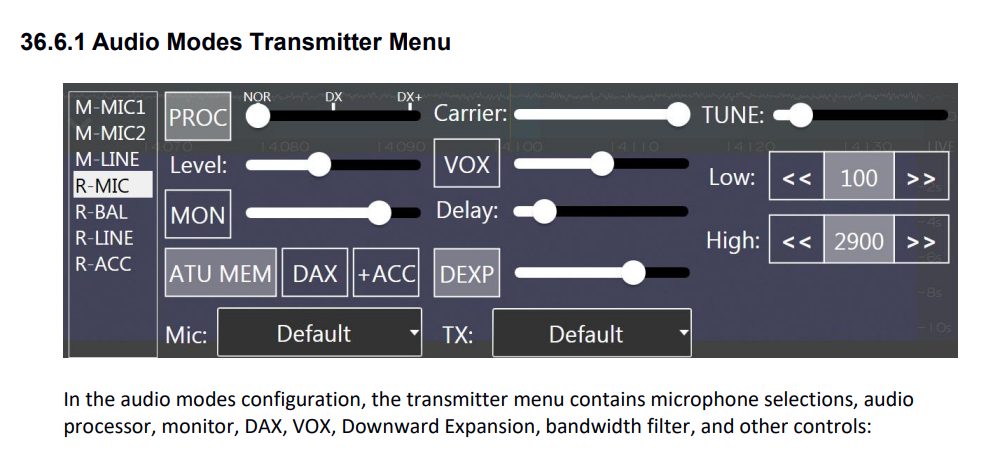

Try this:
- put the ATU in the radio into Bypass mode (push and hold the ATU button)
- Set your Tune power to the level you want (Push TX Menu knob or touch the RF Power part of the Maestro display
- Touch Tune to go into Tune TX - watch your SWR Meter and when it is tuned, take the radio out of Tune.
You control how long it sends a TUNE signal.
Would that work?
Mike va3mw
Hello Mike,
I’m fairly new to the FlexRadio 8400 with a Maestro, and to be honest I just had a look and tried a few things.I can indeed set the ATU to “Bypass”.
What you mean by tune power level – I don’t see a “tune power” setting on the Maestro.
Also, I don’t seem to have a TX menu button?Sorry, I don’t quite follow you – my apologies.
