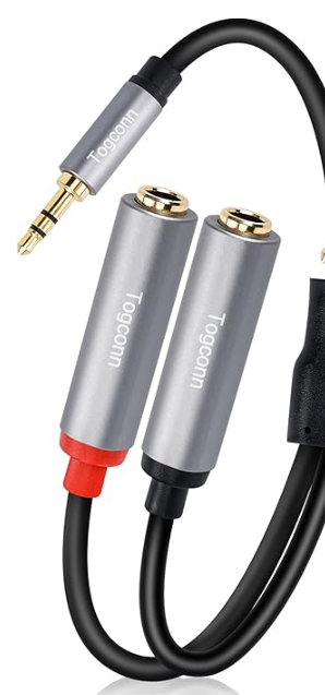

    I have seen some people use one of these and then the plug the Heil mic into one sockets. I think it is the red one.
    It is easy and safe to test. It will either work or not work.
    let us know how you make out.

    If you are going to use the TRS splitter cable, you need to make sure it is a TRS to Left and Right. Not a headset splitter.
