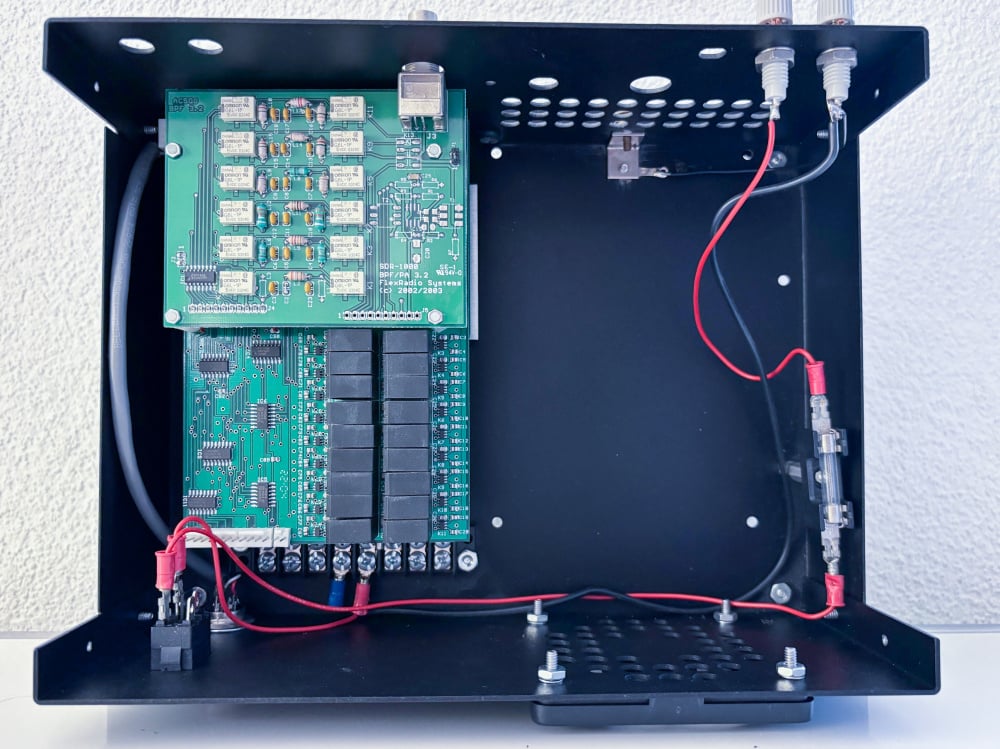

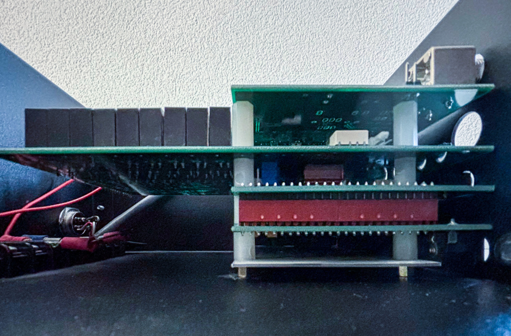

Hello everyone,
I came across an SDR-1000, like a **** giving birth.
I have no idea about this version, but I want to get it up and running.
What I know:
- It is the QRP version.

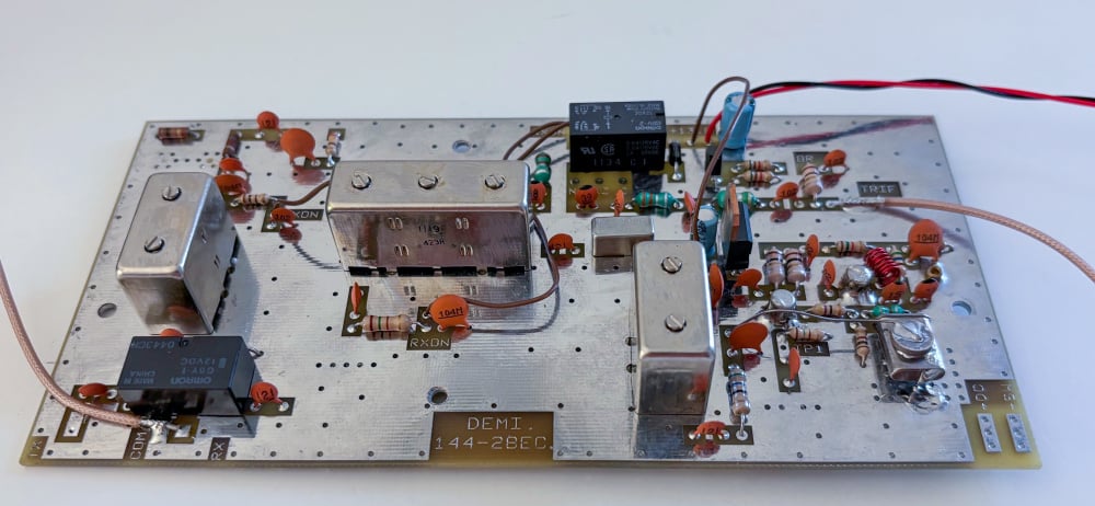

- I still have a 2-meter transverter board.
That's all. Maybe I can get it working with the help of SDR-1000 owners.
Problem:

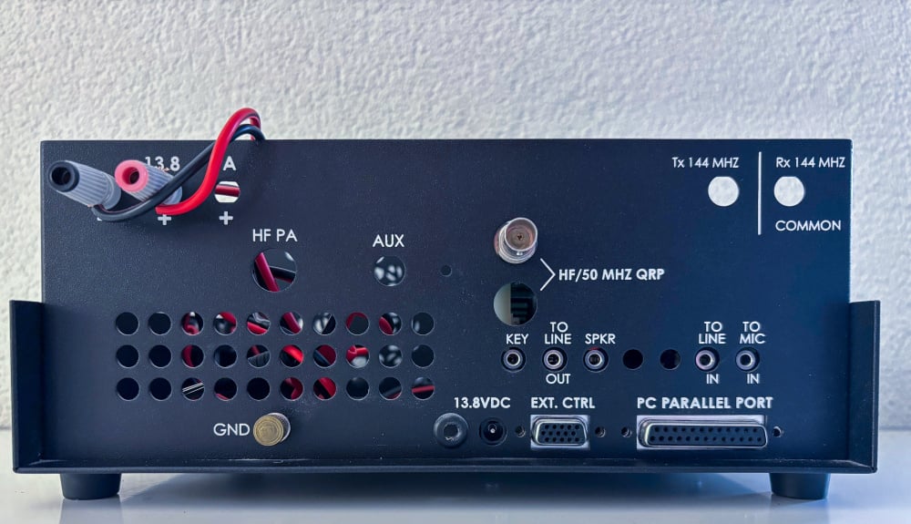

- I don't have the actual PIN assignment for the parallel port, despite the diagram, which doesn't provide much information.
- When I connect the SDR-1000 to 12V, nothing happens. Should something click or light up?
- Are any boards missing (apart from the 100W PA)?
- How do I proceed now?
I also don't kno which Version this is
I think I first need to connect to the PC, install the software (which one?) and then see what happens.
But first, I need the parallel PIN assignment or a ready-made USB to parallel adapter.

- As I remember, the parallel port was a 25 pin straight through.
- On power up, there is nothing to light up, until you have the parallel port connected to a true printer port. I never worked with a USB to lpt port, so you need a motherboard with a LPT port or a true LPT card.

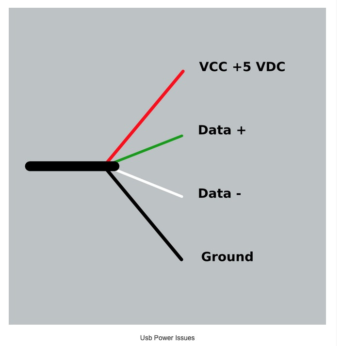

My first step would be to connect the SDR-1000 to the PC.
According to the manual, there should be a parallel port to USB adapter.
However, to my knowledge, a USB cable has 4 wires.
Now I'm wondering how to connect to the parallel port. Do I need another converter in between? If not, which parallel port pins are important?
That's my problem. The manual does not describe this.

A regular USB to Parallel will not work, there was a special one built by a user that has long since gone SK , was the only adapter that did work, but it long since gone since around 2008. Use a LPT port , (some motherboards have LPT ports, but no header, you can buy the headers on Amazon, but look at your BIOS of the motherboard….
