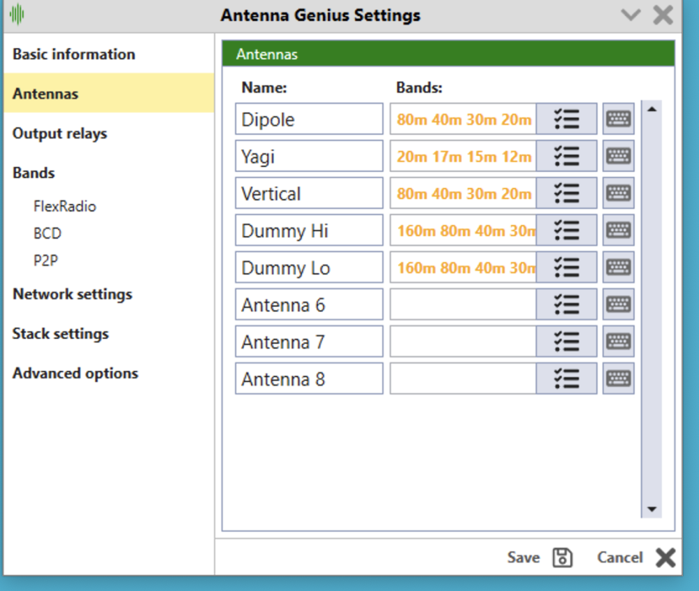

    Alan Member ✭✭✭✭
    Here is a screen shot of my AG Band to Antenna Table.
    Alan
  • Wim Van Cauter
    Wim Van Cauter Member, Unconfirmed ✭✭
    ok, so where do I need to do this?
