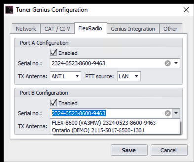

Mike-VA3MW Administrator, FlexRadio Employee, Community Manager, Super Elmer, Moderator adminOptionsThis looks like a bug. I'll report it for you. I just added my 6500 to Port B and it isn't visible.
Mike-VA3MW Administrator, FlexRadio Employee, Community Manager, Super Elmer, Moderator adminOptionsThis is SMART-11296 and it has been reported to 4O3A
