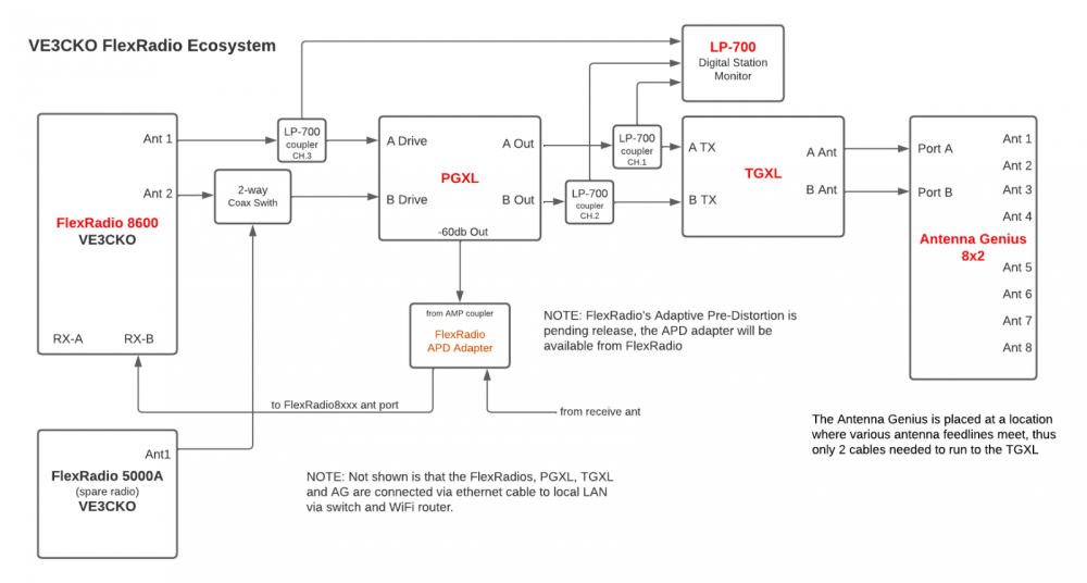

I also have the 8600/SteppIR, on my QRZ page I have a station layout attached below that maybe helpful for connections when you're ready. Don't panic the learning curve on a FlexRadio is pretty fast. You made a great decision just need to be pointed in the right direction to get you started.

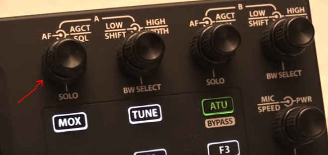

You stated the RF gain is at max. What is your AGC-T set to? It is the outer on the slice volume knob.
They are two different things and this could be where you are slightly confused. VA3MW AGC-T video is for SSDR but it will education you for sure. Watching his and other videos will no doubt bring you up to speed quickly. DuckDuckGo video links "FlexRadio Maestro videos"
