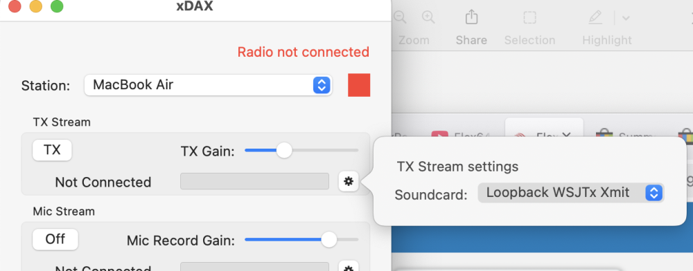

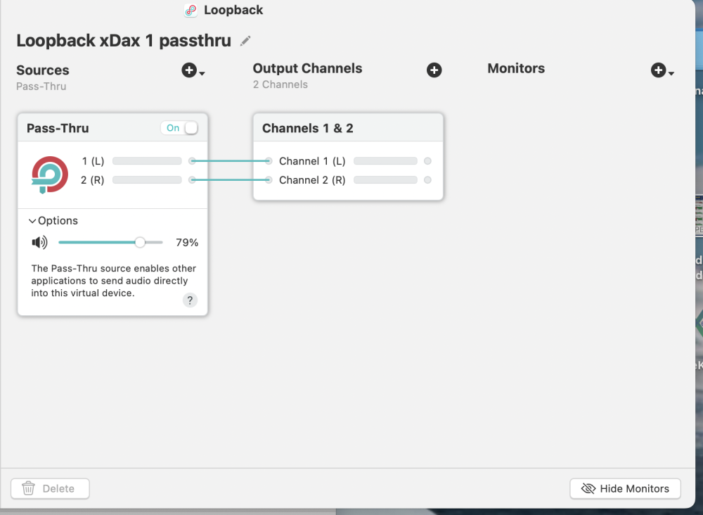

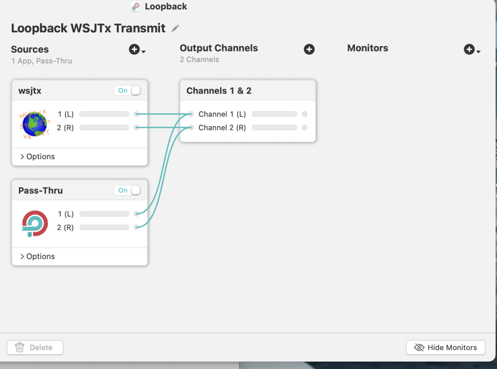

    xcat does not need loopback but do need the audio from wsjtx to be routed to loopback
    this get audio for transmit
    select this loopback device in xdax for
    Screenshot 2025-08-05 at 7.38.31 PM.png Screenshot 2025-08-05 at 7.40.37 PM.png

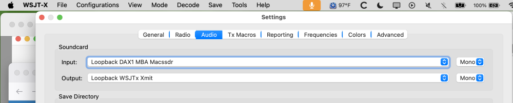

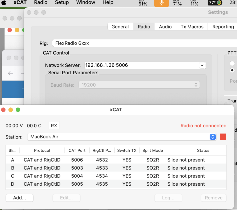

    the 192.168.1.26:5006 is ipa on my mba for xcat and you can see this setting in wsjtx for cat interface fro rig control
    tyhe above shot is for audio routing for wsjtx
