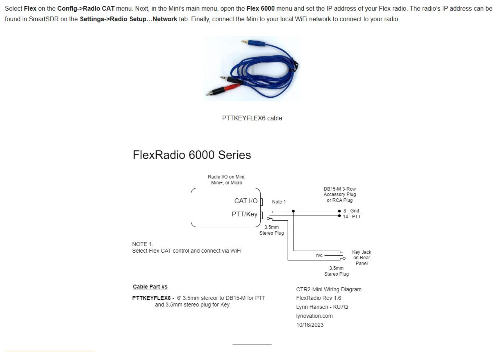

After some research, I found that the CTR2-Mini+ can use the ACC and PTT ports on the Flex. However, you can do the same thing over the network. I finally got my Mini hooked up to the Flex and WiFi.

This is what Lynn sent me. According to this, I would use pins 8 and 14 on the Flex ACC port.
I did get the CTR2-Mini+ working over WiFi, and I'm able to key the rig. Now I get to explore and see what all this can do. It's kinda like my FlexControl on steroids.
